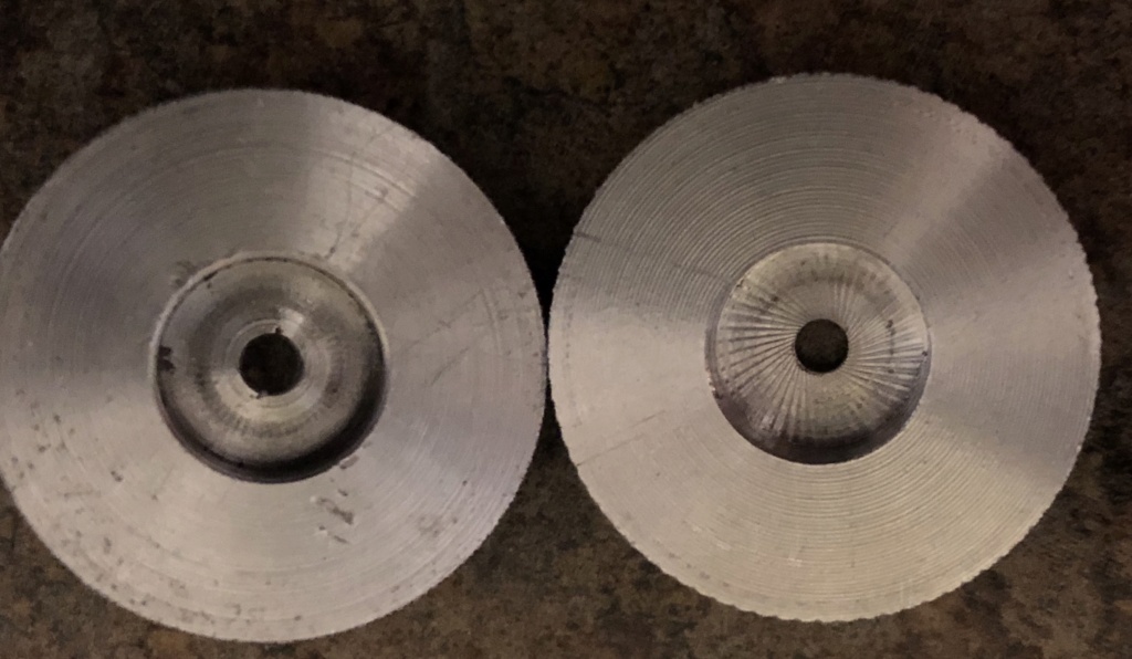

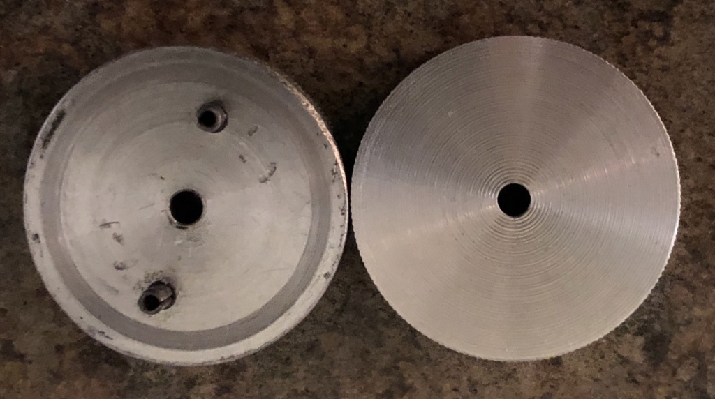

Post  Jason_WI Sat Jan 16, 2021 3:00 am
I found the clutch shaft, grey clutch shoes and spring. Also can send a GTP clutch shoes. They are lighter and probably engage at a slightly higher RPM.
The flywheel for the TD jerobee engine looks to be unobtanium. I have aluminum stock here that size. All that’s left is to drill the two holes for the roll pins and drill and tap the two 3-48 set screws. May not look pretty and knurling on the HF minilathe is almost impossible. Should be called the chatter master 1000. Must also spend more than $9 for a knurling tool.

Post  Cribbs74 Sun Jan 17, 2021 11:38 pm
Oh man! That looks amazing Jason.
I feel like a dirtbag now though. Check your inbox......
Between this forum and kind strangers I have everything I need now to complete this project and more.
I took the time to tear the chassis down and clean it up, just waiting on the mailman now....

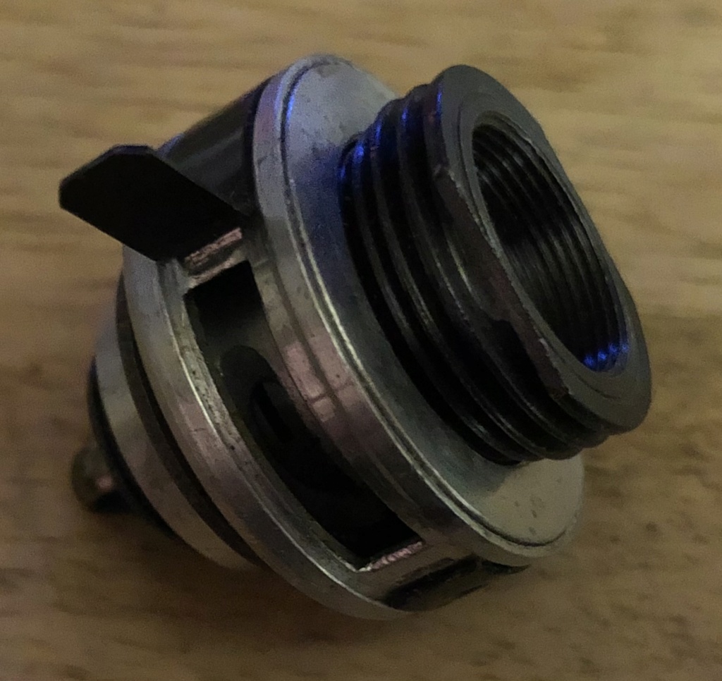

With the early GTP Nissan it used a medallion cylinder with the throttle muffler like on the dragonfly engine. I always had to have the break engaged to keep it stopped. The clutch engagement at idle would always creep it forward. This was on a reed engine though. The clutch shoes on the GTP are lighter. Takes a bit higher RPM to engage. I can send you a set. Also make sure the spring isn’t deformed that holds the shoes together.

Interesting, I thought about the throttle muffler as I have heard good things. I even went as far as to look on Ebay, but nothing is on there at the moment. The spring and shoes I have are new, I really think it’s just I can’t get the idle down. Do you have any experience with the RC .05 carb? I can get one of those easily, but if it’s like the Tarno then forget it.
I think the throttle muffler would be the way to go. If it throttles down and keeps things quiet I am all for it. The TD seems so much louder running on a flywheel as opposed to a prop. I’ll have to keep looking for one. Is the Medallion cylinder ground for use with that?

Post  Jason_WI Wed Jan 27, 2021 2:08 am
I have a spare set I can send you. It’s non SPI set used on the GTP. I ran my GTP with this setup and seemed to work pretty good back in the day. The Maple throttle that came later was good too I guess but never used it. I have a few cars with that here and only ran it one time to see how it worked. I’ll have to dig all my GTP and stocker cars out some day and get a pic.

Post  Jason_WI Thu Jan 28, 2021 1:48 am
Here’s setup instructions for the throttle muffler from the older GTP Nissan manual. This should apply to the Jerobee.
