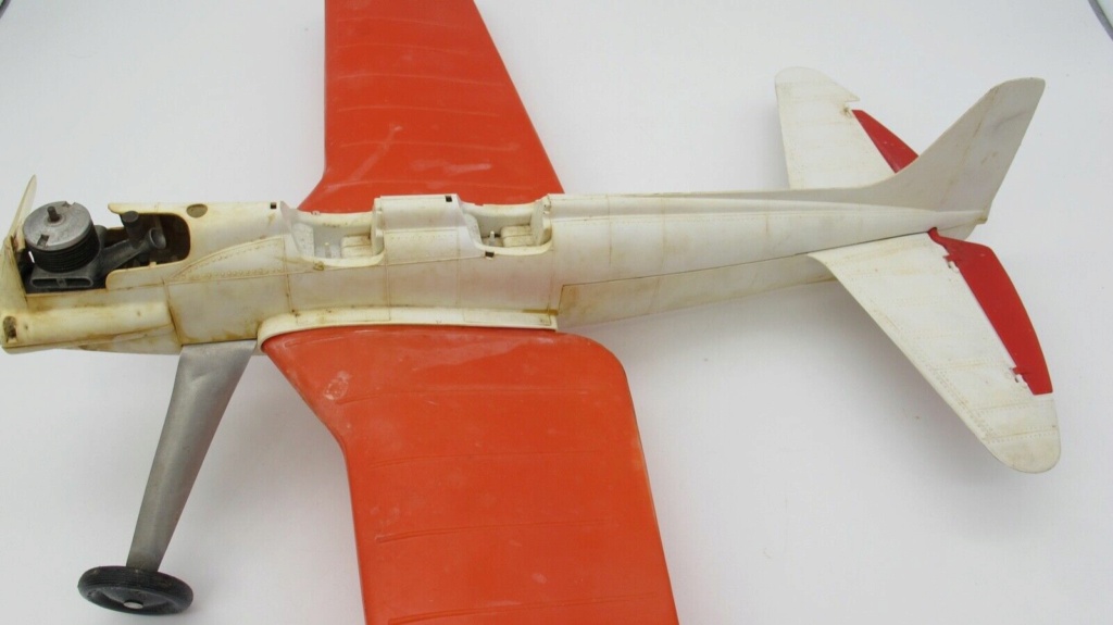

Another Gilbert "SkyFlash"  Gilber24
Another Gilbert "SkyFlash"  75_dol10
This one might actually see air time.  Not much to lose here.  But my pleasure is reworking these.  Well made and designed it's a complicated but rewarding experience.

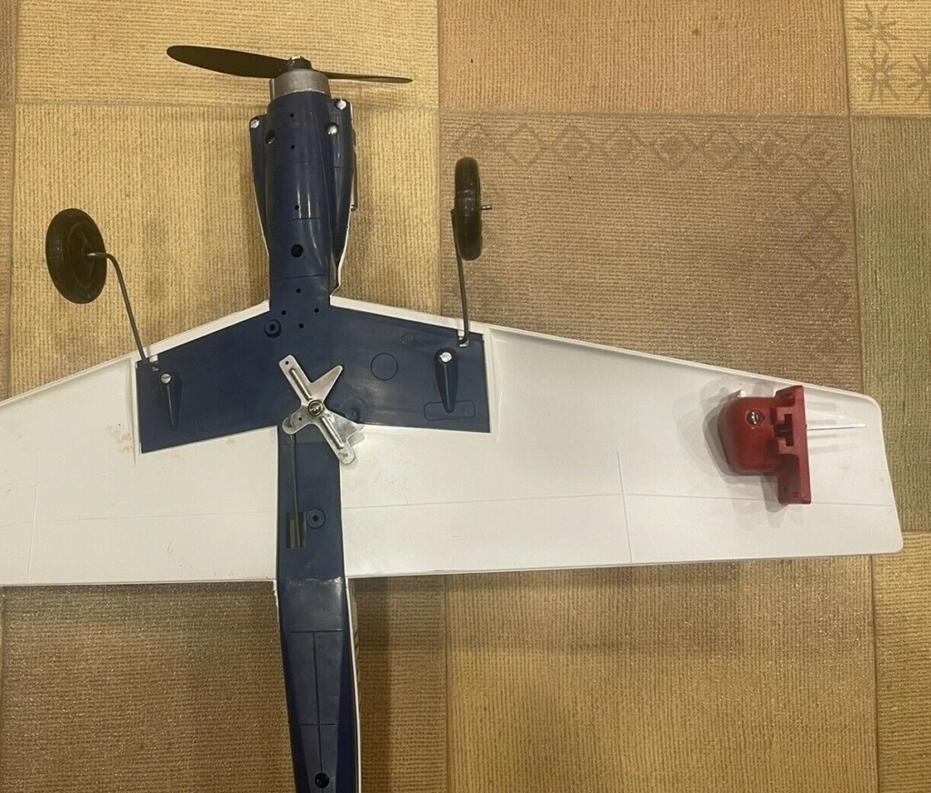

Won an auction for this Gilbert last night.  Got up at 1 am to see it end.
Another Gilbert "SkyFlash"  Gilber27
Another Gilbert "SkyFlash"  Gilber29
Another Gilbert "SkyFlash"  Gilber30
Another Gilbert "SkyFlash"  Gilber28
Completes the three plane set that they offered - Sky Hawk. Sky Flash, and Sky Streak.
Cheap for a NIB powered model airplane.  17 watchers.  Combined bomb drop and leadout mechanism.  Comes from out in Kim's country.
Blows my - No more plastic airplanes resolution sky high........But, these are different, somewhat strange, rare, and a side line to their model railroad/erector set enterprizes.
