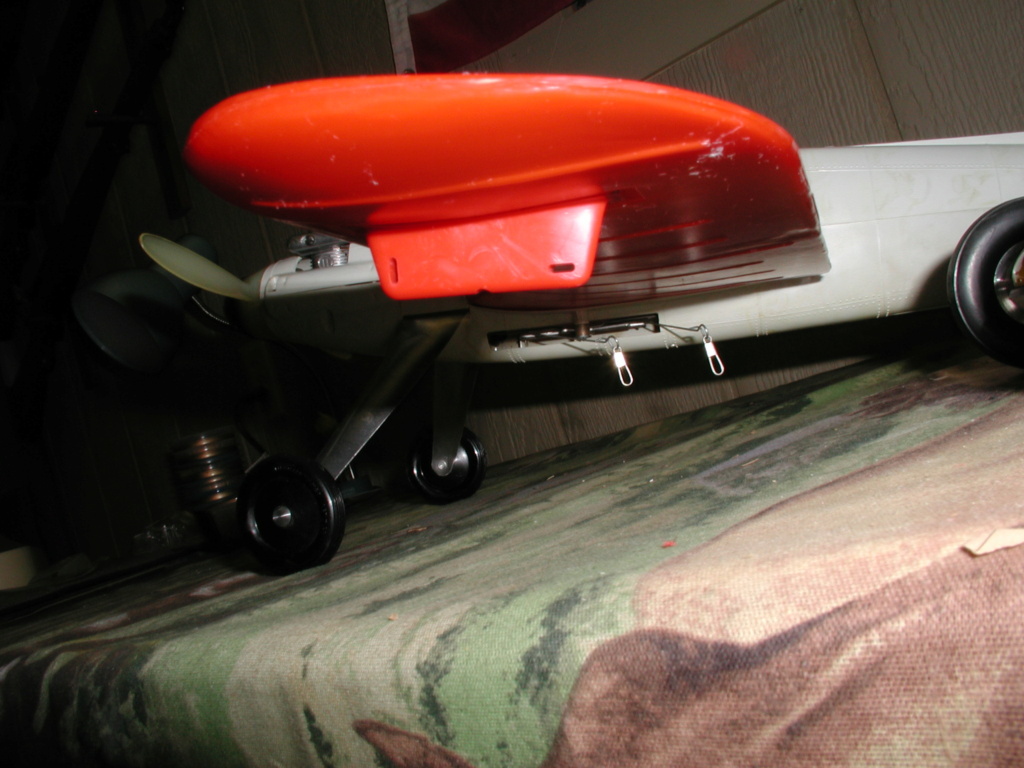

Strange lead-out guide, vertical and horizontal.

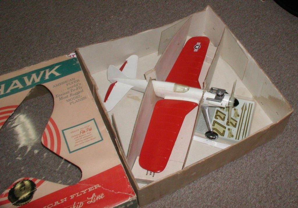

Bob, you had my curiosity going when you showed the unopened box a couple weeks ago. That appears to be one of the cleanest Skyhawks around (or, wrong box? Was the Skyflash the .11 version and the Skyhawk the .074 version?) After your clean-up, it looks brand new! Thumbs Up

Anyone have an explaination for the horizontal/vertical leadout holes? The Gilbert designers had some interesting ideas for this model not limited to this configuration.
Gilbert SkyFlash - Start to finish P1013351
Posts : 9023
Gilbert SkyFlash - Start to finish Empty Re: Gilbert SkyFlash - Start to finish
Post  rdw777 Thu Jun 02, 2022 3:54 pm
I have no idea but, Maybe to allow a little wiggle room to find its groove?…. Back one for yaw and front for roll?…. Wild guess…

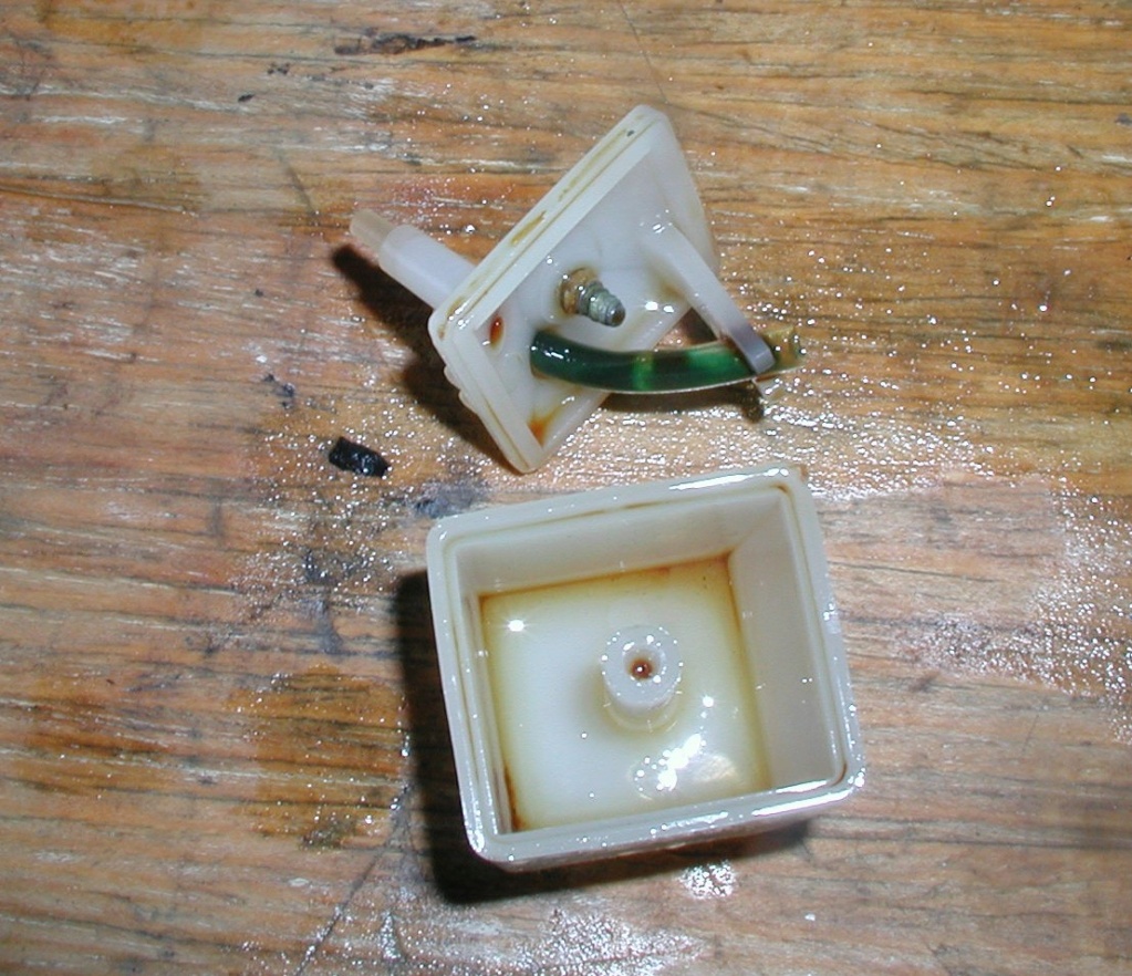

I was thinking that it might have something to do with that strange spring loaded bell crank pictured above. Got to be some explaination when just a couple of holes would do. Huh...
