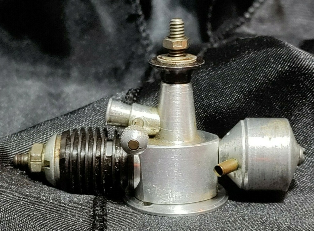

Post  rsv1cox Tue Mar 15, 2022 7:11 am
$9.00 and I was the only one silly enough to bid. Smile
Crispy. Price of two gallons of gas or a pack of cigarettes. It will be interesting to see if I can get it to run.

I wonder if the word "Stuck" pertains to me. Smile

Post  Cribbs74 Tue Mar 15, 2022 7:25 am
You might have been better off with a pack of cigarettes… Laughing
Crispy is right! Willing to bet you can make it right though.
"Won" that K&B Infant Rod.......... Empty Re: "Won" that K&B Infant Rod..........
Post  rsv1cox Tue Mar 15, 2022 7:29 am
Cribbs74 wrote:You might have been better off with a pack of cigarettes… Laughing
Parts cleaner, hot water rinse, heat/RemOil, fire in the hole!

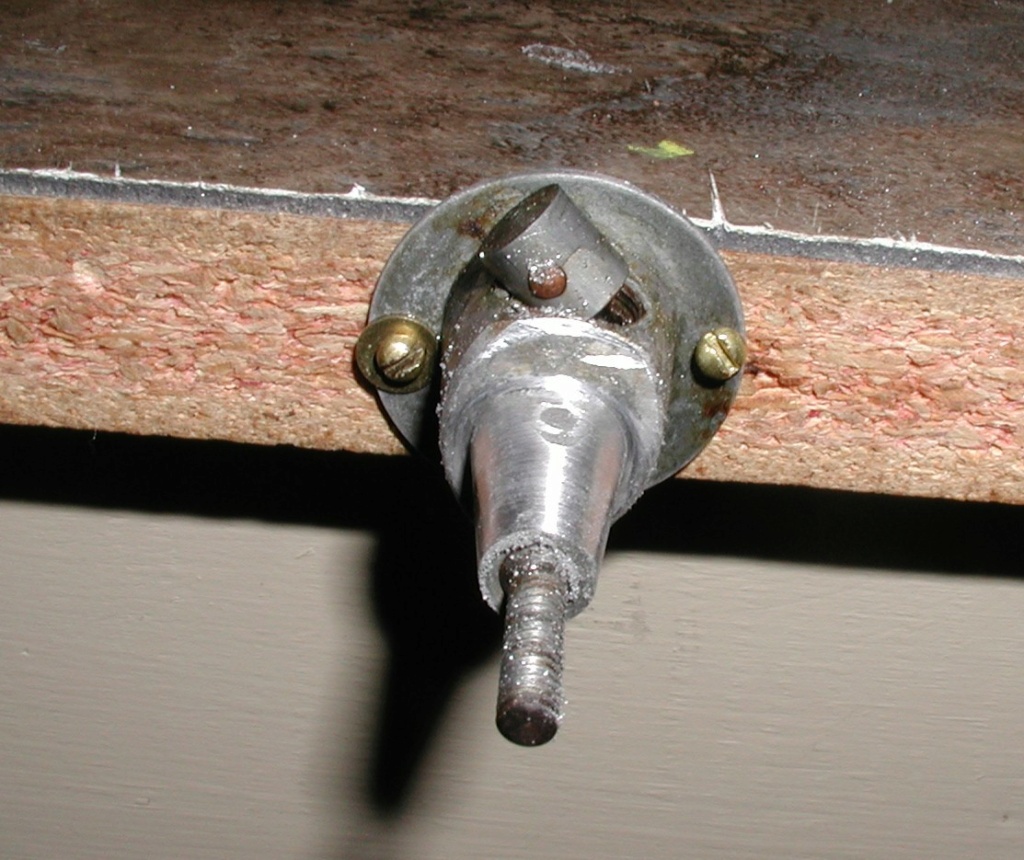

Post  rsv1cox Tue Mar 15, 2022 5:07 pm
Well. ya made me dig out mine. One of the few that I left as received. I don't think I even checked the glow plug.
Tool marks, but smooth with good compression. Tight little thing with no slop in the crank, and a needle with a good solid feel. I could remove the fuel tank but worry about the gaskets. Running it may make me clean it cosmetically but think I will wait for the new arrival.
Could be magnesium but I'm thinking some aluminum alloy. Is there some sort of test to be sure?

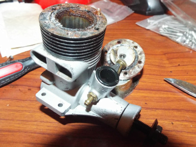

Post  rsv1cox Tue Mar 22, 2022 1:24 pm
getback wrote:It will bee interesting to see if a hole appears in the case . That yellow corrosion is never good . Good luck ! Popcorn
Prophecy of doom Eric.
Got the Infants today. The intake on the complete one was eaten away. I turned the needle and it just crumbled. I will be able to make one complete engine. No tool marks and the pistons and cylinders are fine, better than the K&B that I already have. I think some swapping will be going on. The glow plug looks different from my existing one. The plug is good. I think I have to tap it down and out to remove it.
Got to remove the screw-on rear case covers, hate that, always an effort. Heat (hence the metal propeller) and oil freed the cranks and pistons.

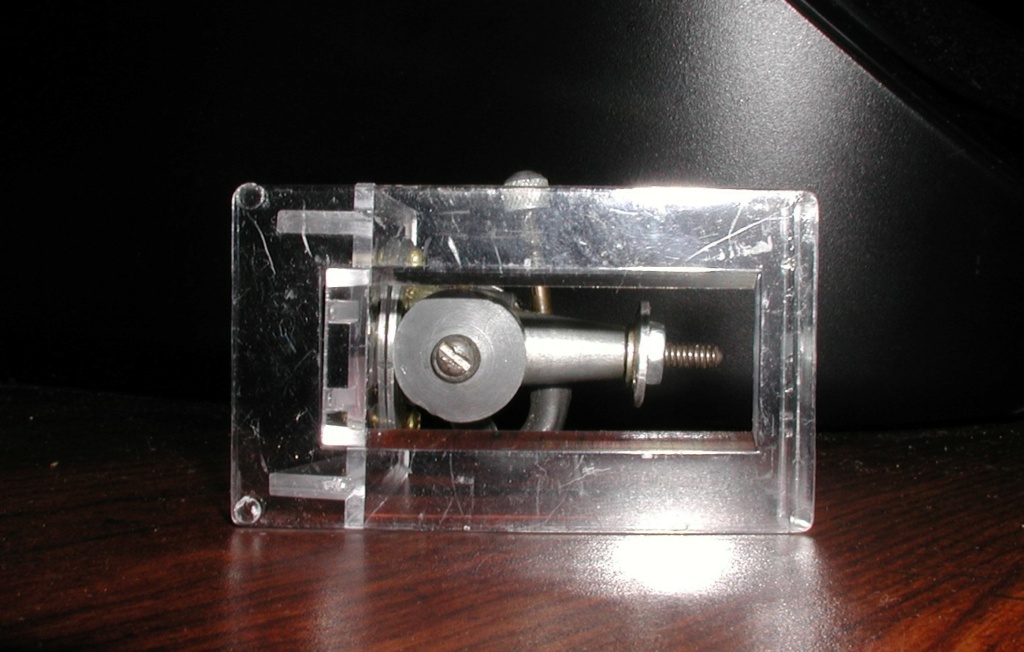

Post  rsv1cox Tue Mar 22, 2022 6:25 pm
Fooled around a little more with the K&B.
Moved the fuel tank over to the .030 from the .020.  Smaller tank (see the top of the proper tank) but it will do to run if I can find the proper glow plug.  If anyone knows anything about these plugs, please fill me in.
Despite my best efforts, heat/oil I broke off the fuel tanks stud in the case, no matter with the ate up intake/NVA it was toast anyway. A 3/48 up through the bottom works to attach it.
