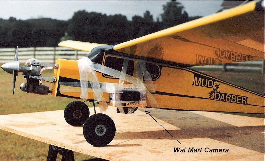

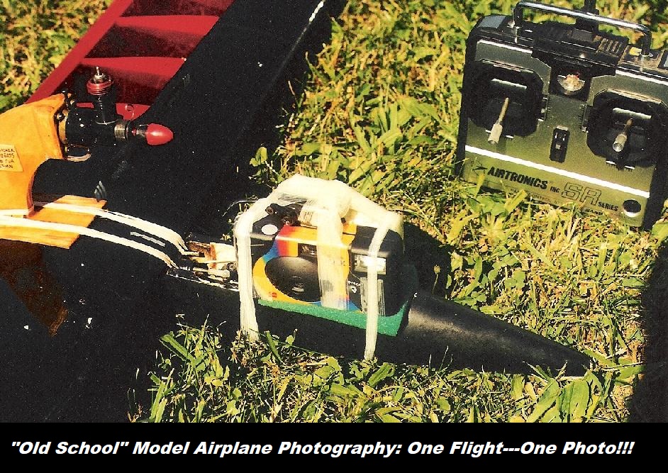

In spite of this, I couldn't leave the idea alone so, in the 1990's, I settled on still photography, using the much lighter Wal Mart "disposable" cameras to fill my need for aerial surveillance.
I lived by the creed (and still do): "It doesn't matter what the camera mounting system looks like if you can't see it in the photo."...and bought myself a couple rolls of strapping tape.
The camera was stuck to my recently rebuilt Mud Dabber (converted from a "nose-dragger" to a "tail-dragger") with a generous amount of the super-strong tape, and with an extra servo also taped to the camera.
Positioned so its arm would depress the camera's shutter button on command, the servo was plugged into a spare channel on the plane's receiver. You got one photo per flight: "takeoff...snap photo...land...wind the camera to a new frame...repeat".
I quickly discovered that the engine's vibration could blur the photo, pretty much at any throttle settling, so I channeled my inner Bob Hoover, climbing Mud Dabber to altitude, killing the engine, and taking my photo at some point during the glide.
This hideous set-up actually yielded some fairly good photos (fantastic at the time) before the digital age brought the great, high-def stuff we've got now. Still, I went through a lot of the "cardboard cameras" on several planes before finally going to the new, easy to use, digital cameras we take for granted now.

Yeah we have came a long way since the 80s . but you know then you would do what it takes to get done what you want or dreams come true . I know I enjoy your photos' and videos adventures in to the a bliss .. I got a chuckle out of the mounting of a motion picture camera on your bird
Still some pretty good pics from the old box cameras !
