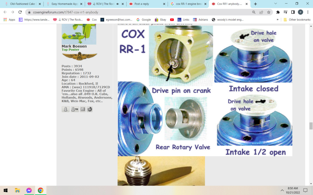

I too have a RR with the ribbed crankcase and tank. Though I respect it as an antique engine, I slso find it vulnerable because of the tiny drive pin that either wears off more quickly than the rest of the rotating parts, or is lost when you disassemble the engine
Posts : 4803
Re: WANTED running tips for the RR-1
balogh wrote:I too have a RR with the ribbed crankcase and tank. Though I respect it as an antique engine, I slso find it vulnerable because of the tiny drive pin that either wears off more quickly than the rest of the rotating parts, or is lost when you disassemble the engine
Wow - thanks! I probably bought the last valve disk as a spare from EX model immediately after I won the auction.
And by the way - that drive pin doesn't come off on mine; it's one piece and part of the crankshaft on mine, so I have no idea what you're talking about.
dragnse7en- Moderate Poster
- Posts : 20
Join date : 2022-09-13
Age : 53
Location : Florence, Massachusetts
I need to disassemble mine to check again..I was under the impression the pin was a separate part..but maybe my memory does not serve me right.
Posts : 4803
Yea if the pin comes out its broken cause thats on the crankshaft and extended to catch the rotor see pics^^^^ there
