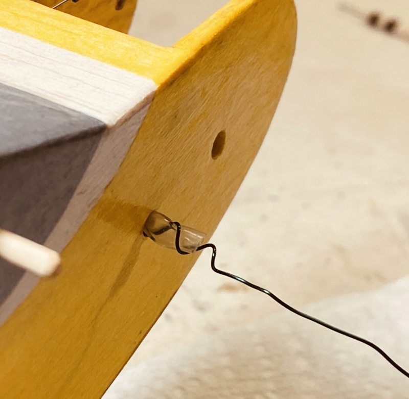

Robert,
Here are a few tips on my use of the balloon tanks hidden inside the fuselage. Unless I bang on an open door with these tips and you already have different methods proven, you may find them of some value:
My ballon tanks have 2 separate lines. A separate filling line will not necessitate the closure of the NV to prevent the engine from flooding while filling the tank
1. The filling line ends right at the inner side if the rubber stopper. This allows the removal of remnant air from the tank after filling, keeping the tank vertically to allow all bubbles to collect at the inner side of the stopper right at the end of the filler tube. By pulling on the syringe after the tank is full, the bubbles in the tank's highest point are removed through the filling line.
2. A supply line that goes deep into the balloon. It is perforated several places along its length inside the tank so that when the fuel is just about to be fully consumed and the balloon collapses, the perforations allow remnant fuel drops to leave through not just the tube end but through the perforations too. This way the complete fuel fill will be consumed, otherwise some pockets in the collapsed balloon would capture some part of the fuel.
For mounting the balloon into the plane I push 2 plastic wires through the filling and supply line openings in the firewall and shove the wire ends into the filling and supply silicon tubes of the balloon tank deep down into the tank..then I push the balloon into the tank compartment until the plastic wires have led the tube ends through the firewall openings.
Then pulling on the free tube ends through the firewall will drive the tank into the inside of the fuselage.

Thanks Andras, Understood perfectly!!…. The way I was doing it leaves chance for a small amount of air…. I have #2 right, The perforated tube to the back of the balloon…. I will reconfigure the stopper as you describe, Makes good sense!…. Your Hunglish is way better than my Spanglish
….. I appreciate the tip
