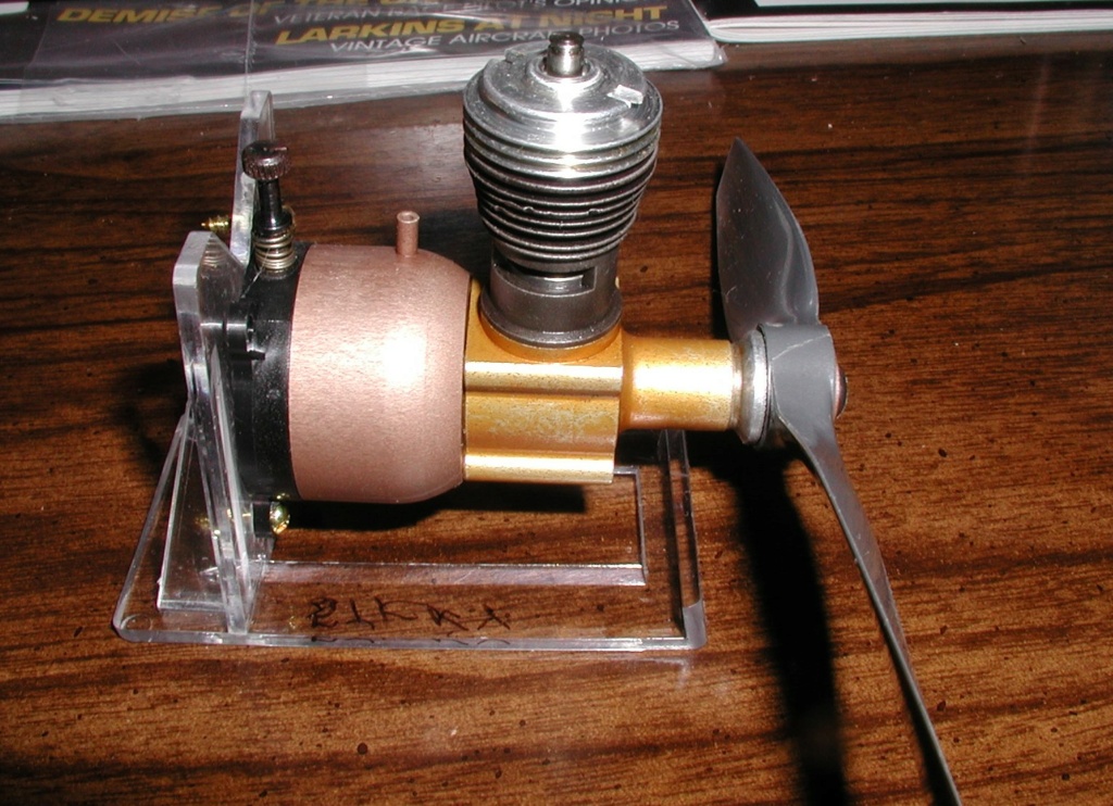

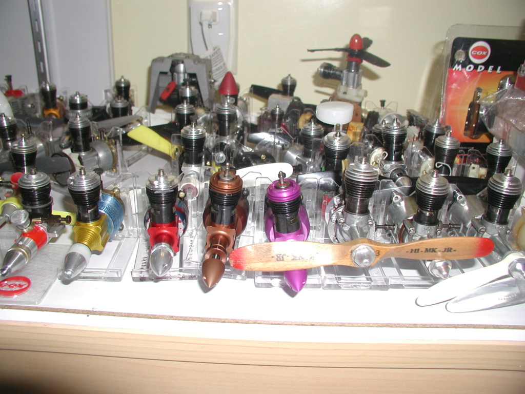

Re: My brand new Copperhead .049 seems to be nothing but eye candy junk
Beautiful Fred,
I'm missing the Blue Bullet, Xtreme, and Terminator. I bought two Graffiti Bee's but gave one away in a contest, Chancey got it I believe.
Did you ever run any of your's, and if you did, did you have problems?
Posts : 9023
I started and ran the Extreme to see if it would be a Tach Race candidate. Don't remember rpm but on 35% it started and peaked high enough to contend. Alas no race that year
Posts : 3975
rsv1cox wrote:Beautiful Fred,
Yep, I have the second Graffiti Bee here safe and sound! And show it off frequently as it is the most beautiful engine I own or ever will own!
