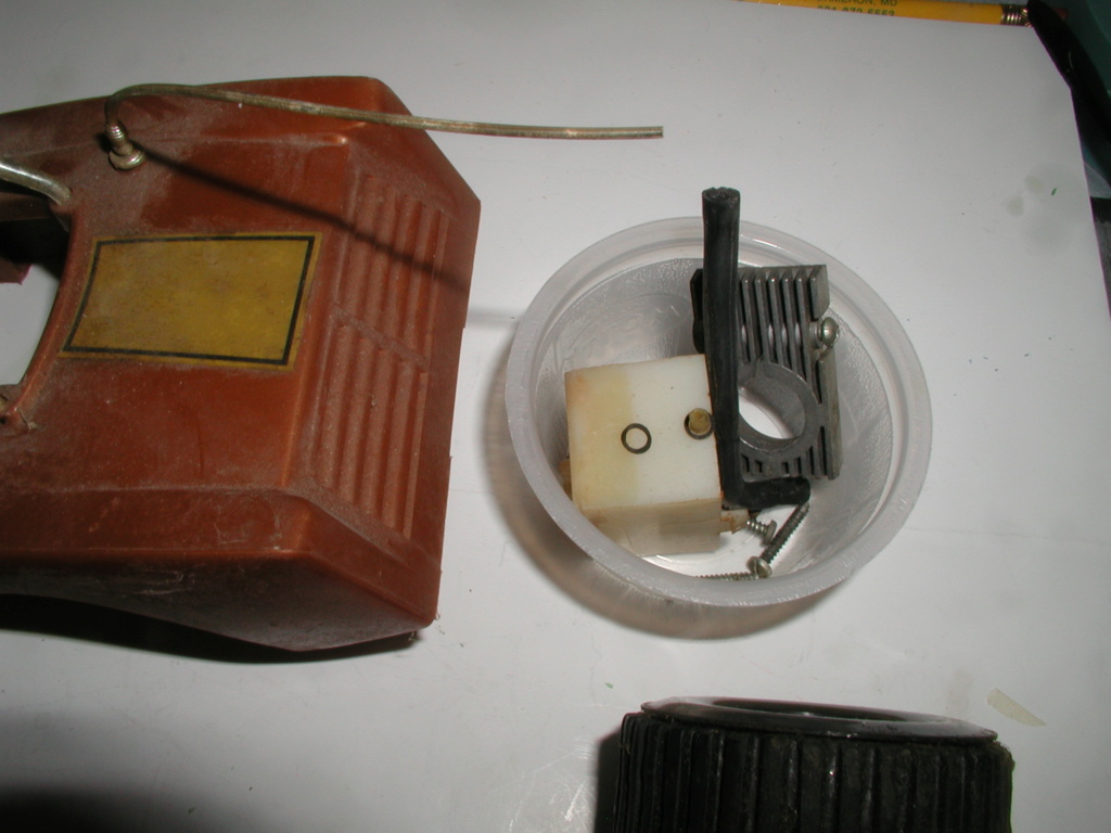

Not a restoration, nothing really broken just locked up and nasty.  Five dollar flea market buy. Mark.
Except for the upper body shell everything got dumped in Berrymans.  Works wonders on castor goo which coated everything.  Berrymans plus heat freed the pull starter.  Many of these twisted wire cords are frayed but this one, perfect.
High compression head.
#8 cylinder.
Milar star reed,
Gaskets on either side of fuel line.  Looks like venturi gaskets.
3/16" socket works on the hex shaft.  Never try to turn a locked engine with the cooling fan.
Drive gear lock/unlock.
Adjustable steering notch locks.
I could remove and refinish all the "gold" plastic pieces and risk breaking them, if I did that it would lead to new decals, which would lead to new tires, which would lead to.....
Stays as is.

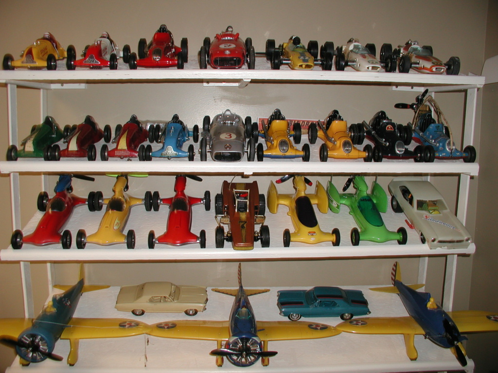

When my son turned 14 I bought him motorcycle, a Honda XR-75 trail bike.  Thought he would never play with his Cox models after that so I threw away his Cox Trike, Sandblaster, Baja Bug and maybe a few others.  They were pretty beat up but he still reminds me about it.
Getting harder to find space for this stuff. I usually keep the bug on a pedistal to prevent the tires from going flat.
