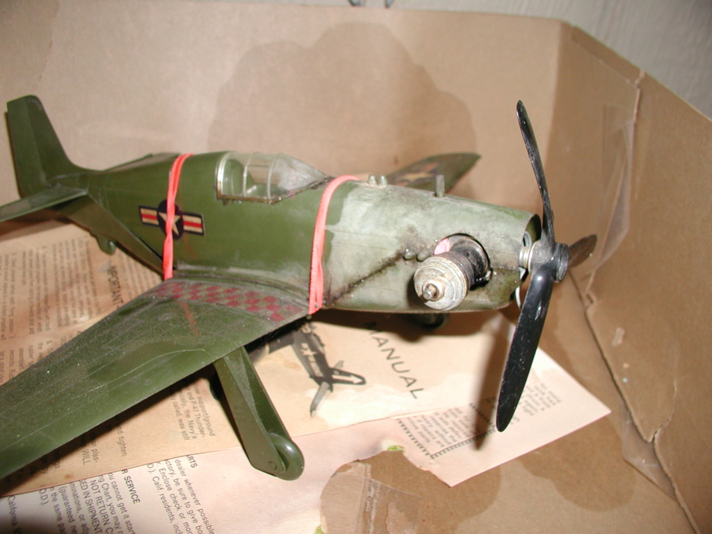

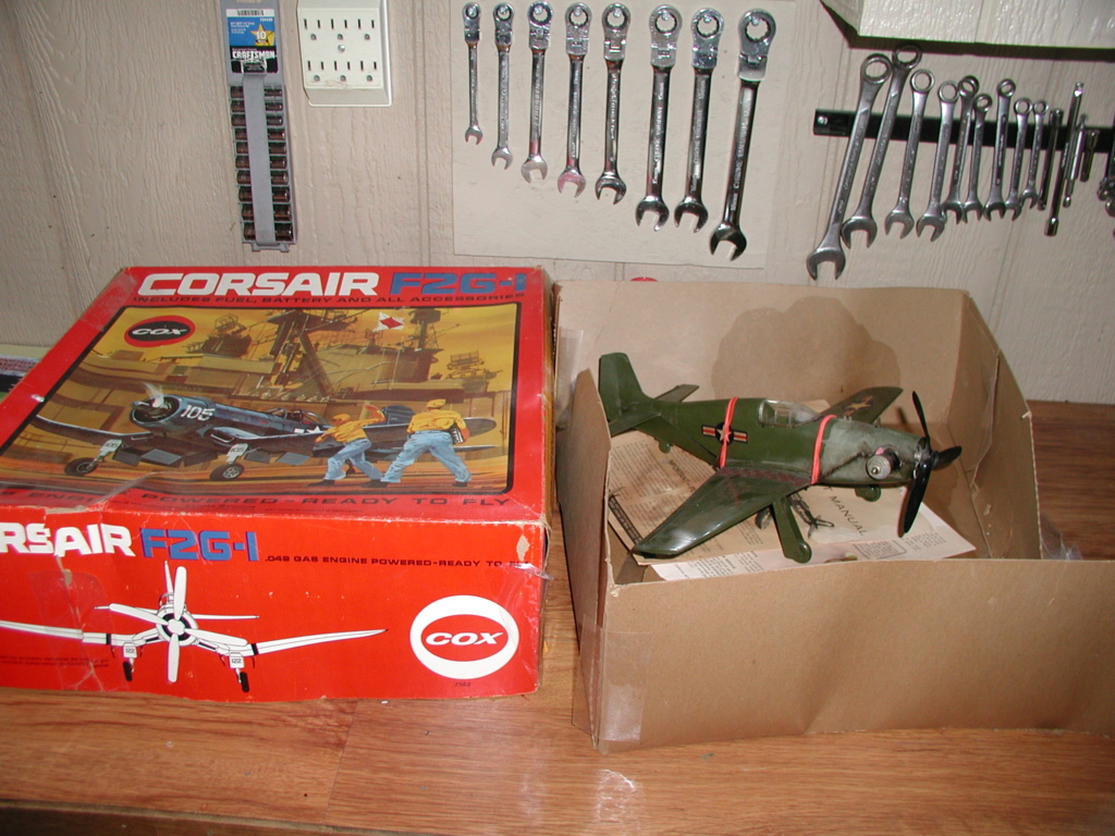

Mark at the flea market this past weekend and stopped to see a vendor friend. Gave Mark the Corsair box and instructions and the P-51 because he has been a good customer. Mark gave him $20 anyway.
Just the right amount of crispy to make me happy. Missing the spinner, a small non-stressed crack in the wing, and the engine locked. A wall hangar with my other non-Cox P-51's after a cleanup.

Appears seller didn't know how to mount the wing. It has molded plastic dowel pins front and back on each side, run them over the fuselage rails at on each side of the wing opening. (Perhaps dowel pins are broken?)

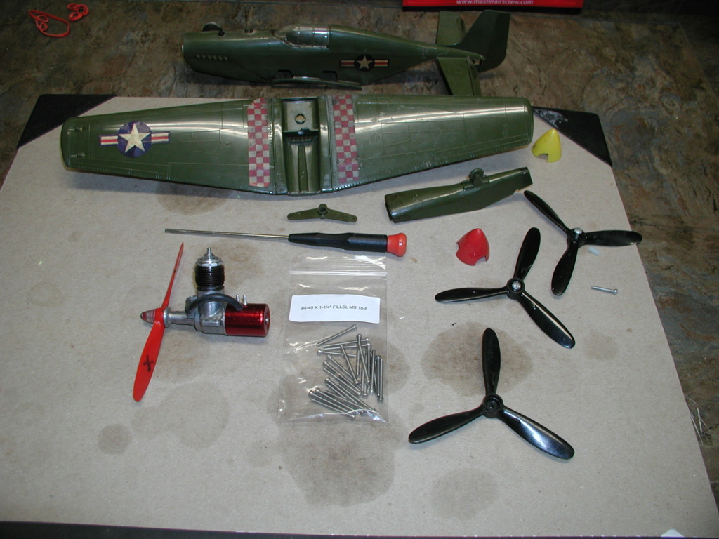

While in the basement I tinkered with it a bit. Castor goo has cemented both front and aft fuselage structures. The bellcrank is there but it's missing the control rod. Minor. Missing the spinner too and the prop is mis-shapen. But the fuel tank, nipples, and fuel line look ok. Rubber band posts are there, just needs to be strung properly.
Whole nose, engine and all will get dumped in Berrymans. I have done this before with no ill effects to the plastics color or finish. Only about 10 minutes does the job.
A Ha.......checked my spare parts and found spare props and spinners. I think the yellow a good replacement.

Got in the 4/40X1 1/4. Perfect size for the Ok Cub's replacement which I robbed for the Fuji.............Fuji that's it. ) ebay, choose your size, length, and amount. 15 each with free shipping. Fifteen should last me for the duration.

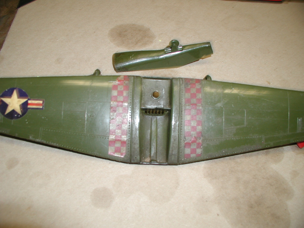

Cleaned up the P-51'a wing a bit and repaired the crack with Testers Red Tube from the underside.
