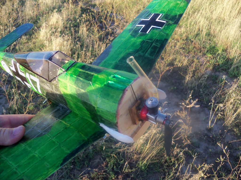

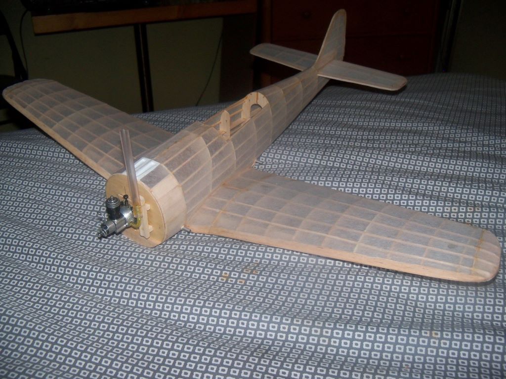

I know somewhere at some time there has been a discussion on fuel proofing. I am showing pictures of an FW-190 from a die cut Guillow's kit. SIG manufacturing shows pints of clear butyrate dope is available, but not the thinner. Is there a good substitute for dope thinner? I have heard of people using polyurethane as an alternative to dope. I have been told that clear lacquer will also work as a fuel proofer. Eze Dope claims fuel proofing up to 20% nitromethane, but I am using 24% Glowplugboy Rocket 24. I have also heard of using superglue as a firewall coating. I have made up some test squares for testing different coatings. I am Lenning toward the polyurethane, but I might use Eze Dope to seal the pores first. Any input on the subject is welcome.

Clear lacquer will not work for fuel proofing. In addition to that, polyurethane is much heavier for a model that your presenting. If you already doped on the silkspan or tissue and you poly over it, it can cause other issues as well on open bays. Dope is special due to it's flexibility whereas poly isn't the same. Once exposed to the sun, the clock starts and poly over tissue can make your covering like a potato chip.In addition, no repairs can be made via dope because dope and poly are incompatible. One is high solvent and the other is oil based. Poly can go over dope, not the other way around. Polyurethane will work it's just that you need to go super easy with it and not hose it on. It will protect against higher nitro but not for very long. The finish will start to crinkle where it has penetrated.
Sig Lite Coat yields the highest fuel proofing qualities over any dope available. However, dope isn't and never was fuel proof. Generally , most butyrate thinners are compatible with each other. I alternate Randolph butyrate thinner with Sig regulary and I 've done the same with Brodak. The issue is how your applying it and the temperature. Sig thinner was very special as it was the slowest drying thinner available commercially for our use. It enables it to be brushed superior to the others because it has more open time. Brodak is a medium rate thinner and it generally requires a splash of retarder. This is because as a faster drying thinner over Sig, it traps moisture on the surface . I've done some very nice brush finishes with Brodak . It takes a bit of a learning curve to do so though. Sig offered the best finish even for the beginner.
In general, most dopes are good to 10% nitro. So the bottom line is don't spill it or get it onto your dope. This can be prevented a few ways. Build up many many coats around the engine area and wax it prior to seeing fuel. Wipe it off immediately if spilled. High nitro is like pouring thinner on your model and on a 1/2A , high nitro fuels will destroy it.
I have no experience with EZE dopes. I believe it's not a dope but some sort of water based product which claims to be aliphatic. Most of these products are thinned down PVA glues which utilize a alcohol base as a carrier to speed drying and improve flowability. I have never used it but I've been aware of it for years and I hear good results with it. I've just never seen a finish done with it.
I've done many models like your building currently. Because of weight concerns, I use colored tissue for trim followed by Sig Lite Coat. I also use another product with these models called Dave Brown Flex-All which is a plasticizer for butyrate dopes. This keeps the covering as pliable as Monokote and makes it rubbery and puncture resistant. It also prevents the dope from shrinking and crushing the model like the stringers.
I'm assuming that what I see in the pic is a Pee Wee .020? You can run it on 10% which is how I generally use mine for free flight on the dropper. Yes, it is down on power but it offers me a little more time on the ground to set it and it doesn't go out of sight in 10 seconds. I'm limited to space so one thing I do is turn the prop around and lean it up a fair amount on the 10% which offers a nice slow speed but it does the job.
Your model looks terrific , I'm looking forward to seeing it complete and I wish you success. Nicely done. Ken

Was doing spit and sputter test with rich running Babe Bee. I used samples coated with both Eze Dope and Butyrate Dope. I would run the engine for around 1 1/2 to 2 minutes. Then I would use my finger to smear it around the square. After a few minutes I would wipe it down with formula 409. Both finishes held up peaty well. One thing for sure u need at lest 3 coats of 50/50 of ether one to seal well. My test stand had a coating of super glue on part of it. It works ok for some amount of sputter, but raw fuel will soften it. Notice the horseshoe pattern left by the engine backing plate.

Thought l would do an update. Flying with a 4 1/2 diameter 2P prop on backward. Model had enough thrust to go Straight up and stalled then recovered, but second time around it did not have enough height and hit the ground. As you can see it broke a prop. I didn't have the cowling on because I have not decided how I was going to do the plug wires and the needle valve extension. At any rate it definitely has enough thrust to fly. Need to make shims for down thrust.
