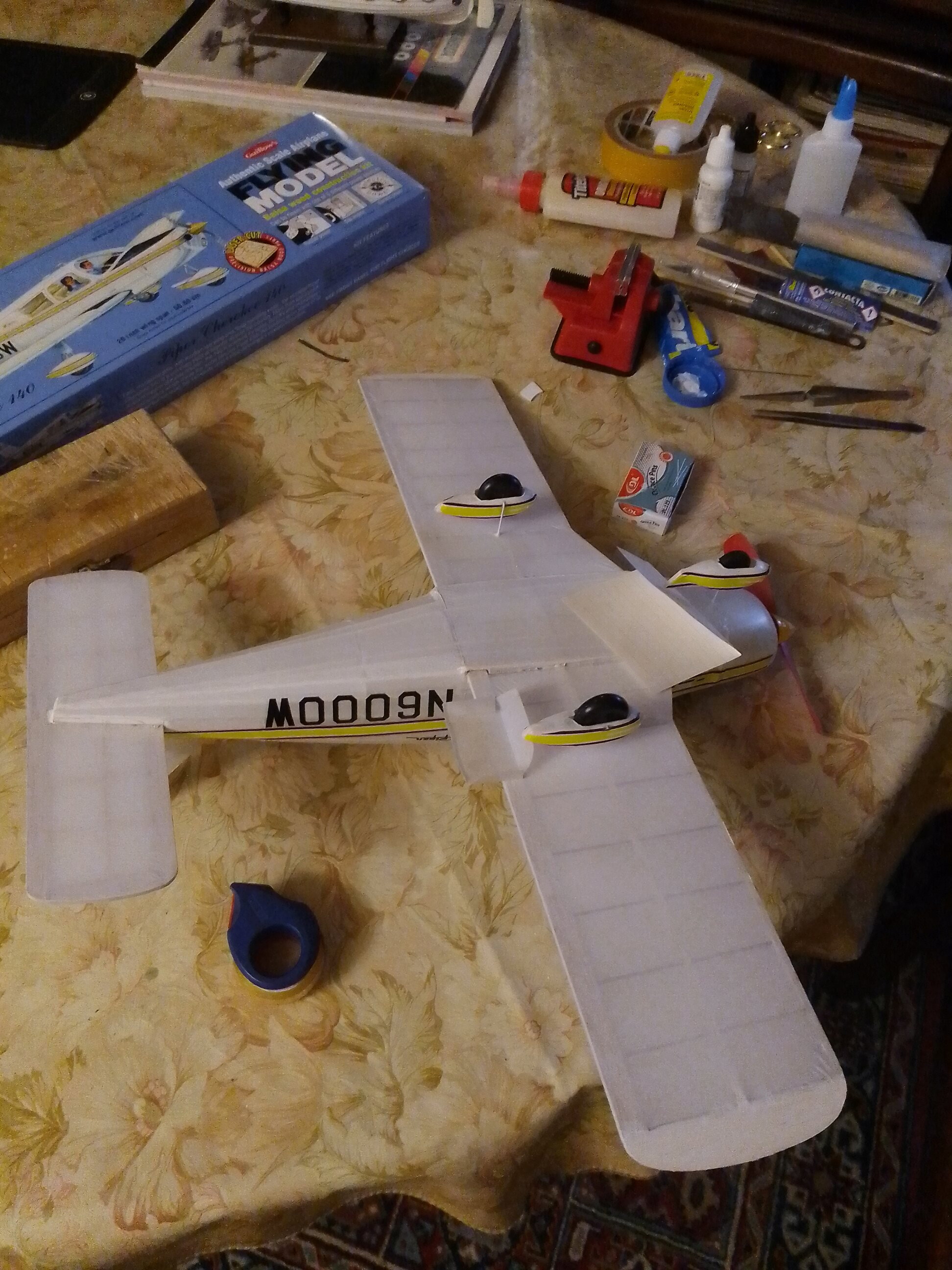

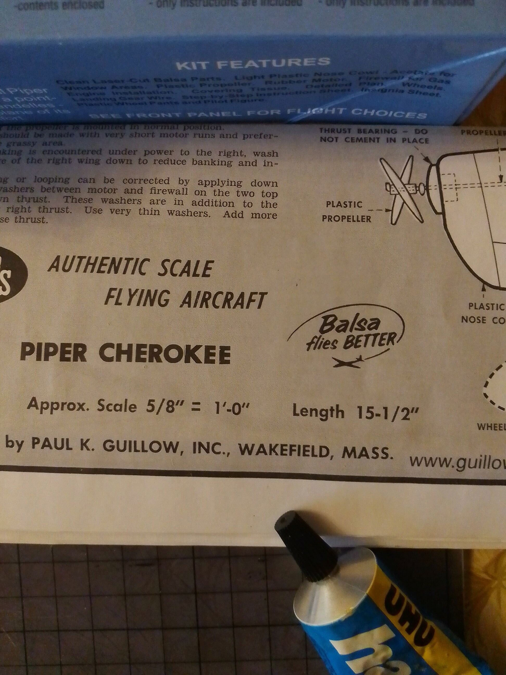

Post  Levent Suberk Fri Sep 08, 2023 11:02 am
Building a Guillows Piper Cherokee 140 rubber powered model nowadays. It is my first rubber model since 1970s, didn't fly a rubber powered model for more than 50 years. Electric and control line instructions are omitted in Guillows kits, but .020 powered free flight instructions are included. I know that building these small stick and tissue scale models need more skill and patience than building big scale models with engines, so I think that scale models at this size aren't for kids.
Note that "Balsa flies better" Very Happy

Post  rdw777 Fri Sep 08, 2023 12:20 pm
Looks great Levent Very Happy ….The building looks neat and clean and covering looks good too!!….Just follow the little Guillows booklet to do the curves on the fuselage….A couple of tips if you’re planning to fly it….The props in the Guillows kits are terribly inefficient…If you can get a little block of balsa a much more efficient one can be carved… You may already know how…. I can walk you thru it if you would like to try…..
Guillows kits usually tend to be heavy so find the magical tall grass for landing on your first test flights….. Looking forward to see how it turns out…. Thanks for sharing Very Happy

Post  getback Fri Sep 08, 2023 2:44 pm
Looks really Good man you got a jump on it and should come together for you with out a problem , Is this a old or new kit and U using the silk that came with it , Looks Good on it Very Happy Popcorn

Post  rsv1cox Fri Sep 08, 2023 2:51 pm
Nice Levent. You must have painted the pilot, I envy your steady hand. It will be interesting to see how you finish it.
"Balsa Flys Better" - yes if you don't load it down with cement and dope as I tend to do. Sad My only surviving Guilows model is a Nieuport 17 last "flown" about five years ago, yes into tall grass. I might have got 20 feet out of it.

Post  Levent Suberk Fri Sep 08, 2023 3:33 pm
getback wrote:Looks really Good man you got a jump on it and should come together for you with out a problem , Is this a old or new kit and U using the silk that came with it , Looks Good on it Very Happy  Popcorn
It is a new kit not a vintage one. I use the covering paper supplied in kit, somewhat different textured paper. I used white glue thinned with water instead of thinned dope for covering. Sniffing cellulosic glue a little is a part of the model building for me, remembering childhood days Very Happy

Post  706jim Fri Sep 08, 2023 6:30 pm
While it probably shouldn't matter, I'd think that a low wing plane like this Cherokee would be less stable as a free flight than something with a high wing. My experience anyway.

Post  akjgardner Sat Sep 09, 2023 5:31 am
Nice job, are you using dope or white glue on the tissue?

Post  Levent Suberk Sat Sep 09, 2023 6:32 am
akjgardner wrote:Nice job, are you using dope or white glue on the tissue?
Thanks. I used thinned white glue to glue tissue on frame. Didn't taute tissue covering yet. I am going to spray a mist of water to tauten it, then will apply a light spray of clear acrylic.
