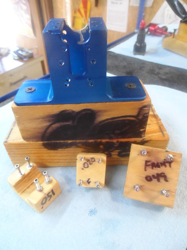

Yo Ron,
I know this is a little after-the-fact but, one way to avoid the hassle of 2-56 hardware is to make up a set of hardwood blocks, fitted to the back of the test stand.
I got myself a free, near-lifetime supply from the scrap bin of my friendly local cabinet shop.
With just a few minutes' investment, you can make several sets to match anything you're gonna mount to these stands, and REALLY cut down your time by using #2 socket head screws to hold the engines.
Just to be a bit fancy, I give the blocks a quick coating of thin CA to stretch out their useful life.

Good idea Kim, I think the best solution would be to make that stand out of steel and then tap the holes. Better yet weld bungs behind the holes for a little more meat.
Re: TD tach race 2012 (Engines on the way home)
Maybe so, but that hardwood block takes the threads of those wood screws and won't let them back out. Either way...whatever gets it done !
Posts : 8256
Kim wrote:Maybe so, but that hardwood block takes the threads of those wood screws and won't let them back out. Either way...whatever gets it done !
True, it certainly would have helped!
