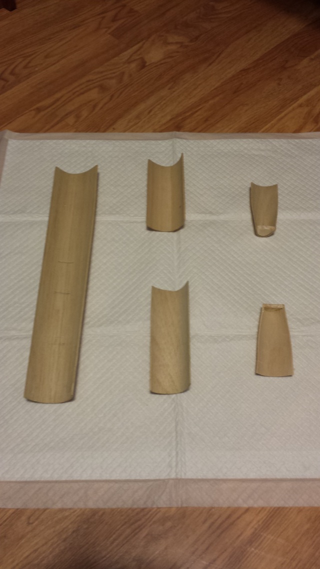

Starting a new project, its something that's different from any that I've done before.

Post  RK Flyer Sat Nov 16, 2013 8:11 pm
Sorry Dave & Crankbndr you guys arent even close so no prize!
dckrsn-- No steam involved all you need is a form , Ace bandage and a super secret ingredient that every household has!
And since it was a person from this forum that gave me the info.....
I used a  an 11/2" wooden dowl 1/8" balsa sheet and .....Windex glass cleaner.
The 1st. step was spraying the  balsa sheet with the windex on both sides, let in soak in a few minutes & spray some more. It will start to get real easy to roll & then just wrap it around the dowl or form, then wrap it tight with the ace bandage. Let it set overnight. Step 2, I used smaller dowls to get the taper I wanted, sprayed with more windex and used painters tape to hold it over night.
I'll post more picts as I continue ......RK Flyer  Flying

Post  RK Flyer Sat Nov 16, 2013 10:44 pm
Nope! Its not rubber powered !
 "IT" Will be 15" long x 11/2" in Dia. in the center section about 11/2" dia at one end & 11/4" at the other & maybe a little bit oval when its complete.
