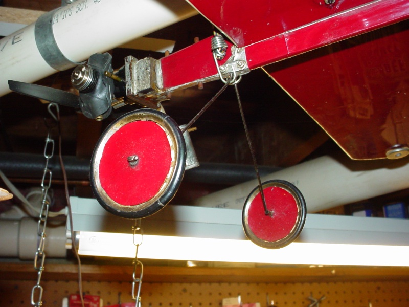

Bob, that looks great! Like Kim mentioned; you can cover those spoked-wheels. A real easy way to do it would be to measure your wheel-rim and cut 4 discs to that diameter from lightweight card-stock. Center-punch with the axle hole size and put aside until you're ready to paint the model. At that time, you can decide what color to paint them. I did this with 2 different models.. and it worked really good.
These are made from index card-stock. Not beautiful.. but not bad. The wheels cost 25 cents ea. at a craft store. (many years ago..)
Nieuport 28, coming along Wheels10
these were painted..
Nieuport 28, coming along Dsc02217
and these were covered with Monokote..
Nieuport 28, coming along Dsc02218
