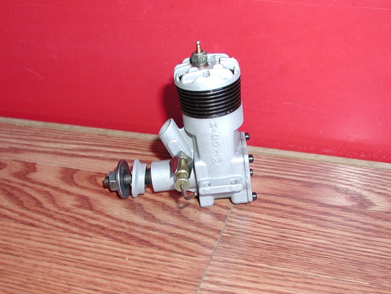

McCoy .29 ? _ This is wrong, right?
The cylinder sleeve should have the fully open port to the inside, while the restricted port should be on the exhaust port side. Or is it correct in this picture?

Re: McCoy .29 ? _ This is wrong, right?
Thanks Bandit, I have seen them both ways too, and that's the problem as some have been disassembled before and who knows if they were put back together correctly.
I have many of these McCoys and try to make a mental note about how they are arrainged when I disassemble them, but missed this one. I will do the high in/low out and see if it runs, if not I will swap them.
Roger that, while it looks OK in the pic and I don't see the top edge of the intake side of the sleeve protruding down in the exhaust (clear indicator that the sleeve is in backwards) its always good to check. BTW " its high out\low in" lol (bandit)
I experimented some more with the position of the cylinder in the case. I don't think that it can be installed wrong because of the triangular arrangement of the three long cylinder head screws. They dictate the correct alignment. You can get it "wrong" but the cylinder port will not align with the exhaust of the case.
Anyway, I put it back together and got it to run rather well for about 30 seconds, long enough to know that everything was correct. Then it stopped on it's own and would not restart. Somehow the compression went away, almost free-wheeling. I retightened the head screws criss/cross pattern and the glow plug, still little compresson and no start. Too bad, it's a nice looking engine but I have read where these McCoys may wear before your very eyes.
Yes the piston moves. It has some compression and these do tend to lose "pop" when warm. I haven't given up on it yet.
I should explain, the first picture is just representative, they are two different engines but both are McCoys.
Yeah the top engine has a separate sleeve and can be put in backwards that's is why the newer engines have a locating pin on the top of the case that iindexes the sleeve in the right position. The steel cylinder engines are drilled in such a way to help make sure the cylinder can't be put in 180deg out about the compression, have you tried inspecting the sealing surface between the head and sleeve or top of cylinder? (Bandit)

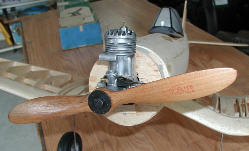

Success. It runs like a champion. I ran it twice hand checking the compression after the first run. Started right off on the second run, took a little coxing on the first until I found the NV setting that it liked.
I also ran the .29, another rebuild. I had trouble with this engine before not wanting to start, a fuel tank positioning problem I think. This time it started right off and ran strong. Likes lot's of needle though. What a sweet little engine this is.
The .29 was swinging a 10/6 prop, the .35 a 9/4. I should have swapped them but those were the props that they came with. If I ever mount them in a model I wil re-prop them. I used Sidewinder fuel, a model car fuel with 20% nitro. I did not want to use my Cox 25% fuel. Both ran well on it, but the battery is dead on my tach so I couldn't check the RPM's.

Thanks guys. The only castor oil available locally is medicinal and I have heard conflicting reports about using that. Should I ever mount these in an airplane and run them a lot I will surely find some.
I bought the .29 to use in this F4U advertized for C/L or R/C. The previous owner had built it for R/C and I am having difficulty figuring out how to make it into the C/L version without a major rebuild. Unfortunately the plans didn't come with it.
