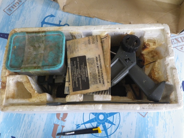

The seller did write me back!! The car arrived today brought by the postwoman. Well packed, it arrived in one piece and in the original, well "patinated" box. The seller was a bit generous with tape though. The cover is entirely printed en Français. The car was not sold Under the COX name but simply as GASSERS. It was not imported by GRAUPNER as all Cox products for Europe but by AL-ES France.
COX GASSERS arrived today Imgp7710
COX GASSERS arrived today Imgp7711
COX GASSERS arrived today Imgp7712
When I took the lid off, I found the transmitter, the instructions well soaked in fuel, and the necessary Tupperware box with "extras". The car was underneath with body and a repaired spoiler.

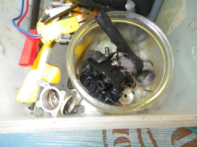

In the Tupperware box: the tank, battery box, spanner, another engine with wire mesh cylinder in bits and broken conrod. servo parts, screws, the broken off part of the front bumper cheers and a cutter knife.

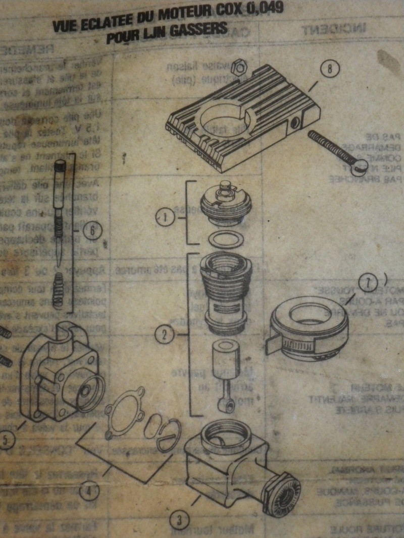

The engine certainly can be improved. I dug out the fuel drenched instructions and found the exploded view of the engine with parts list.
COX GASSERS arrived today Imgp9012
COX GASSERS arrived today Imgp9011
It's all very standard according to the part numbers. The cylinder is the single ported one. It's got the standard glow head and a product engine backplate. I don't know what part the exhaust muffler/ throttle is. It's number 20467. Some ideas? The engine doesn't have a ground cylinder with matching sleeve for throttle as for the Jerobee. I didn't find any info about the gear ratio.
Posts : 1684
COX GASSERS arrived today Empty Re: COX GASSERS arrived today
Post  getback Sun Mar 13, 2016 8:27 am
What I see is a muffler with a throttle clip on it should rotate on the cyl. and I think set the exhaust defector to the way you want it to go , I have never used one but have a few and have put them on after cleaning up so they will move Eyebrows Eric

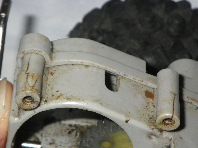

I'm rebuilding one of mine. It's the car pictured on top of this thread and is the worst one. I also got tyres that went off. It's always the left rear tyre near the engine. I replaced it by a wheel from the other side. The tyre pattern is wrong but I can live with that. The cooling might be a problem as the engine is well "protected" by the body. I see you're missing the heat sink though. It's just the standard one. Another serious problem I found was the rear axle. The rear axle is very thin and not hardened. They will bend or break in way of the pins that go into the slots in the wheels. I had a bent axle on the car and in my pile of bits, I found one more broken axle. Straightening the axle is possible.
 COX GASSERS arrived today Imgp2410

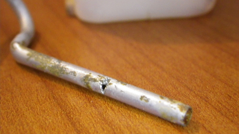

Materials do not resist to aging. Next to the tyres going bad, there's also the plastic plots for the screws on the chassis or on the gearbox casing that break or split. Even the aluminium tube in the fuel tank I found corroded.

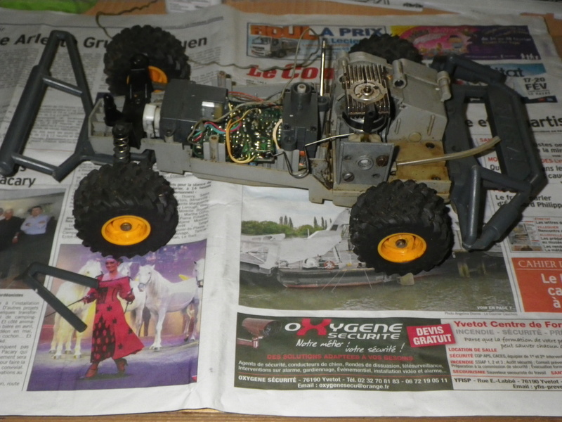

To give more cooling to the engine, I bought some pipe to make an open body as the one on the Kyosho Land Jump. That will make a difference.
I rebuilt the chassis and engine. I'm now figuring out how mount proportional RC. Below 2 before/aft pics
