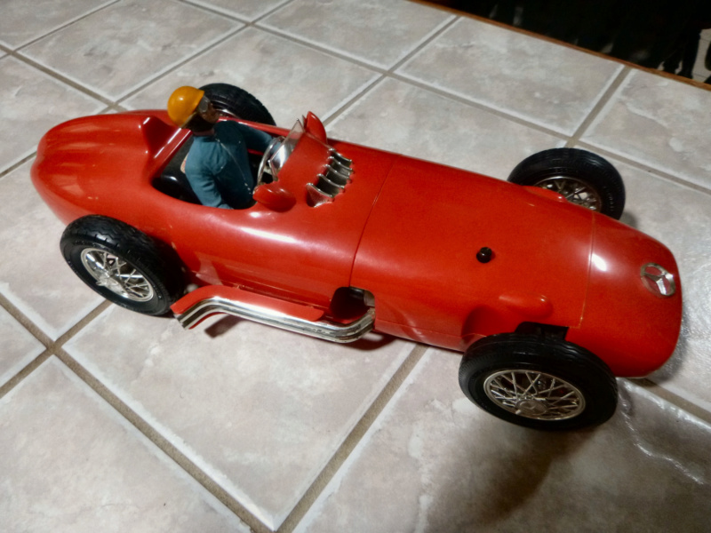

I'll have to say my hats off to the Cox employees that assembled the Mercedes car as it was quite difficult. Thanks to members Mudhen and Bob for parts and advice it is complete.
Many parts had to be fitted, the screw bosses were a problem and even tapping them with a body screw caused stress marks in the plastic. I wound up enlarging the holes so that only a few threads on the end of the screw engaged. There was still enough purchase to hold the halves together well.
Notice the wheels aren't on the axles yet, I assembled this way only to find the outside c clips will not go on, had to take it back apart.

WOW, She's a thing of beauty! Great job of putting everything together. Thanks to Mud's and Bobs help you've restored a piece of history!
