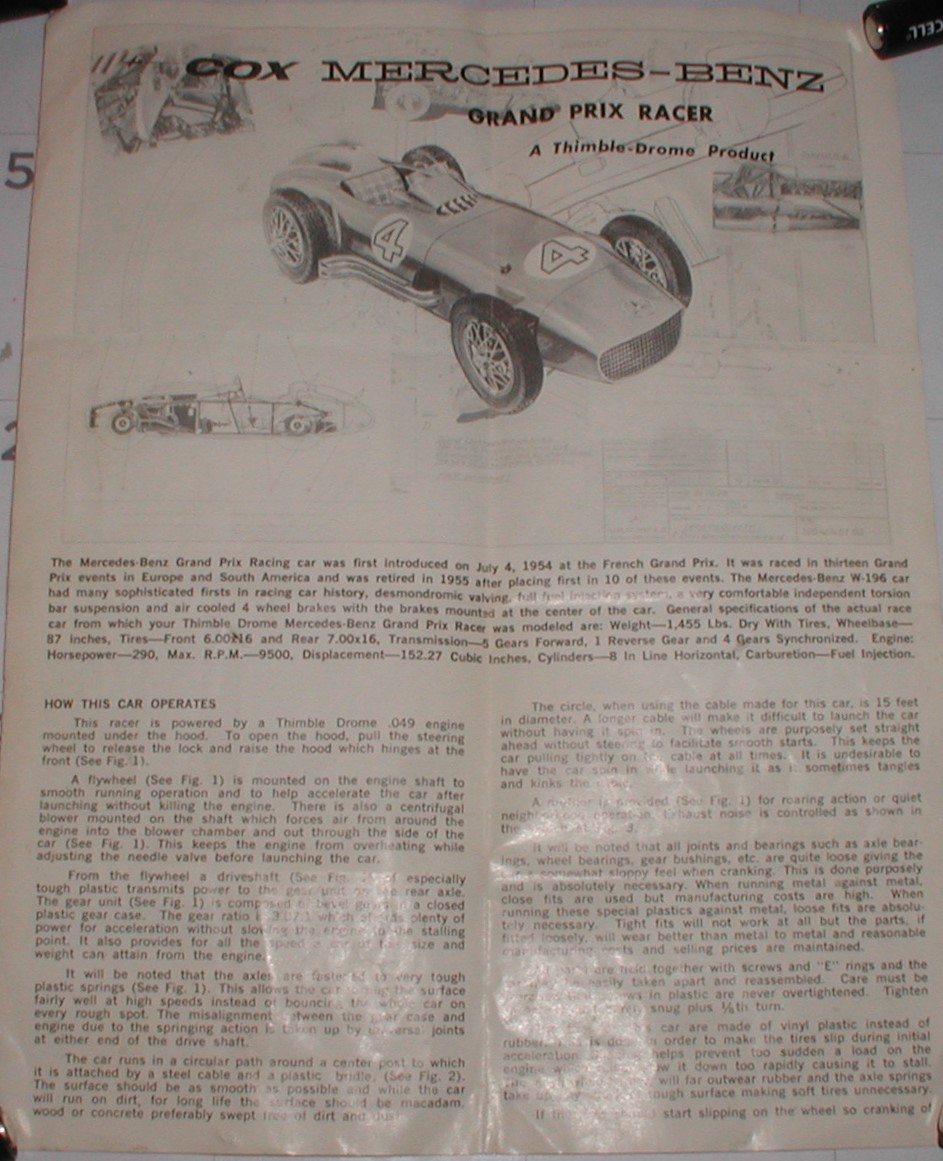

Bob do you not have the sheet of instructions for the this model or did i over look it in the instruction. sheets ?? Oh and Thanks for coming by , knowing you have more experience than anyone I know on CEF , Cool

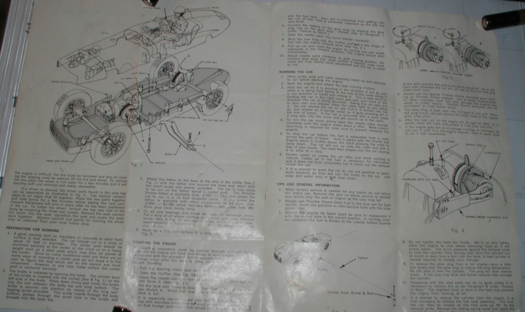

getback wrote:Bob do you not have the sheet of instructions for the this model or did i over look it in the instruction. sheets ?? Oh and Thanks for coming by , knowing you have more experience than anyone I know on CEF , Cool
Thanks Eric, I thought that I had sent them to Jacob but evidently I didn't. I have crystal clear scans but I can't up or down load them as the "Files are too large".
I took pictures, perhaps they can help Jet until I figure out how to load them.

I did find a pdf manual online back when i found the car, but that last page wasn't in it. If you could scan that page i would appreciate it.

I have it scanned, I just can't download it because of the files size.
Working on it.
