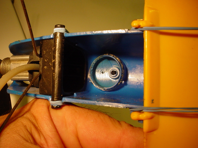

The tank on my PT19 is a translucent/white "bowl" that I've had problems with coming unattached.
This "old" fuse shows the tank in place..
I've glued it back on.. but I think it originally was supposed to be a "snap-fit". A new bowl would not snap on either.. so I figure that the mount on the fuse is worn.
Your tank may be a snap-fit too.. but it's the first one I've seen of that type. If you can (easily) pop it off.. you can make a nipple from a small flared lead-out tube installed from the inside. Open up the hole to tightly fit the tube and use small-size silicone tubing cinched-up tight.. to hold it in place. Reinstall the tank and you'll have a more "original-looking" repair that is un-noticeable.

I fixed the fuel tank by super gluing a 1/8" nylon hose barb into the hole, after drilling it out slightly larger. The tank was also cracked so I coated it with some miracle liquid plastic stuff that the wife found on one of her shopping trips. Seems to work, the tank doesn't leak.

Hi again! Hope you got a few more flights in. I'm not sure if you mentioned having any extra props. I should mention (following-up my last post..) that I flew my PT-19 on 25' lines, which was dictated by the size of my flying area at the time. It may well be best to purchase a few of Cox International's 5" x 3.5" L/H props to try. As I said; I've used 6" x 3" R/H props.. (without adding tip-weight..) but flying with longer lines might be a bit more "sketchy". This airplane is a flight-trainer.. and the 6" x 2" L/H that it was designed to use; actually torque-rolls the model to the "right".. which really helps if a breeze blows-in. The model will be less likely to lift the outboard wing and come in on you. This is a BIG advantage to running reed-valve engines on small models.. because of their ability to run equally well in either direction.
My PT-19 came with the "zero-drag" L/H starter-spring.. as yours has. These are hard to find. Make sure that you keep track of it when and if you remove the engine from the model. It's not a part that would ordinarily be removed.. unless you chose to run a R/H prop and starter-spring. Keep it with your spare-parts! It's one of those parts that you'll want to have when you need it.
If you get the urge to fly without a pit-man.. you can make a simple "pin-stooge". The PT-19 has a tail-skid that affords a point to accept a stooge-pin.
A pin-stooge is easy to make! Take a look at these photos. The "pull-chord" runs out to your handle (line-length).
The "pin" holds the model (engine-running..) until you grab your handle and pull the chord to release it. You should have no trouble with roll-out (ROG) with those big wheels.. even on short-cut grass! There's nothing more satisfying.. than a nice rolling take-off to start your flight! It gives you some time to gain some composure... and ease it on up to about 5-6 feet, and level-out.
