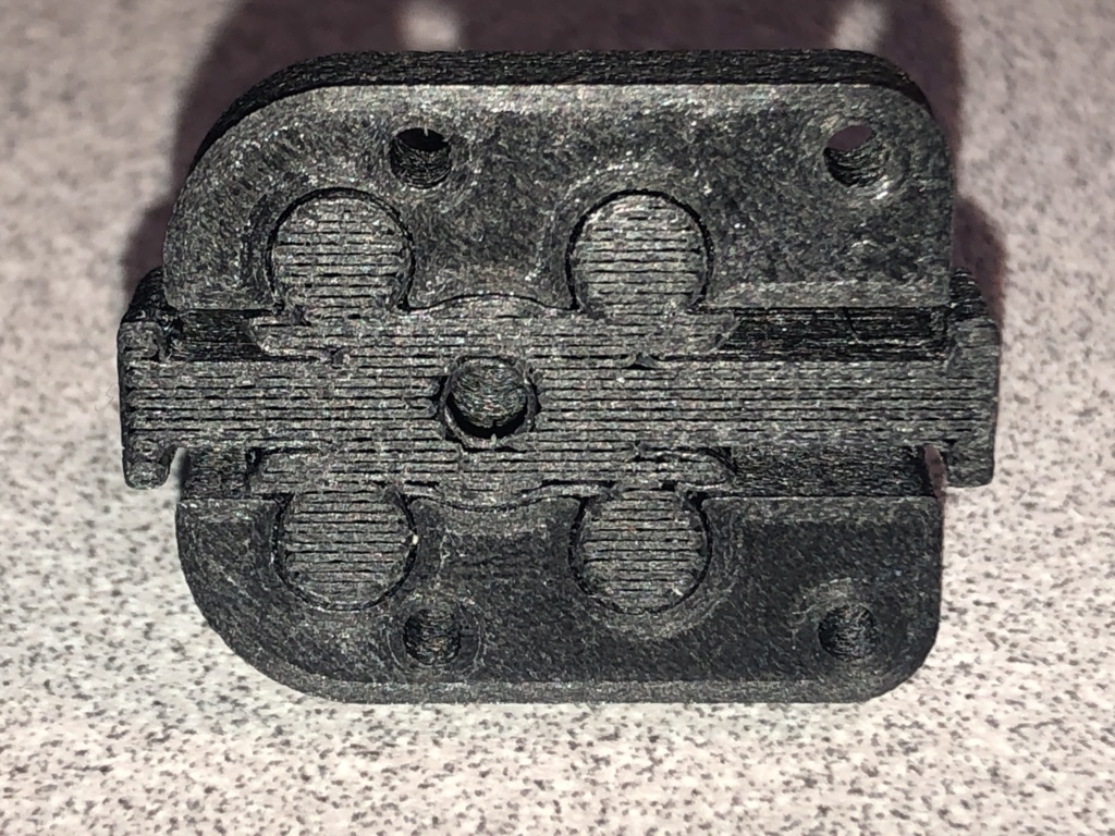

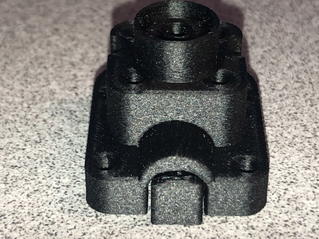

Post  Jason_WI Thu Apr 30, 2020 7:15 pm
I have been letting the carbon fiber Zytel filament in the dryer for two days on the high setting before printing. The prints have a smoother surface finish by doing this. Also using Dimafix direct on glass leaves the bottom smoother vs using garolite LE and having to chisel it off.
With 80 units in the field it’s been mostly quiet as to how well they work.
