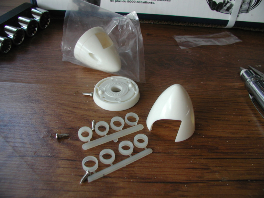

I want to use a spinner, but of all my props this is my only 9/4 and I will have to drill it out to use the provided spacer. I have bunches of 9/6+ wooden props but the hubs are to thick to accept the spinners backplate plus the prop washer. This nylon Top Flight just doesn't look right, besides it's not Ken approved.
I have thought about sanding down and balancing a 9/6 to fit the shaft of the Enya, but that may not be a great idea. Anyone have a sacrificial wood 9/4? I'll trade you for most any size prop of your choice.
I'm pretty sure this plane had a spinner at one time. Also an Enya .19 instead of that Fox .15 as the mounting holes suggest.
