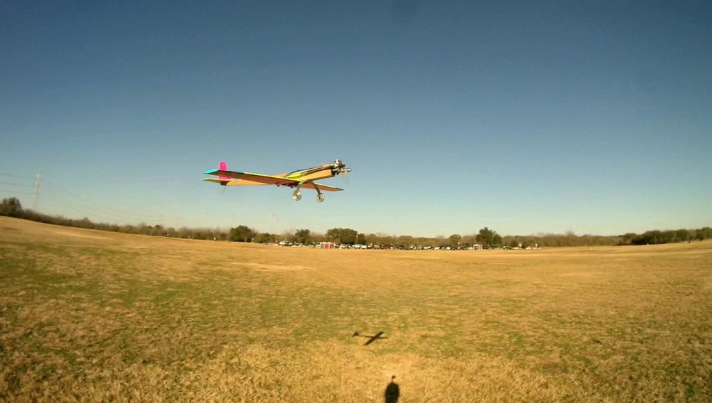

I have been flying this Lil Roughneck, powered by my home made Killa' Bee (aka TeeDeeReedy) for many years. Pictured here when freshly built more than 4 years ago:
The plane is a ball to fly. Designed originally for 020 engines, the 049 powerplant makes wonders.:
The many hours of stressed use and landings in deep uncut grass have left their marks on the plane. The monocote was punched on several places allowing castor to find its way to the balsa, and I also noticed the stabilizer detached from the fuselage, and both the rudder and elevator, with stock thickness of 1,5mm only, were cracked beyond repair.

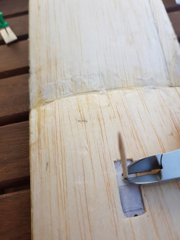

During the past week on a foreign trip, I had enough time to figure out how to patch a hole on the box/sheeted wing of my newly refurbished Lil' Roughneck...and had the time today, back home again, to perform the surgery.
Some of you may have a better technology, I found mine quick and dirty and amusing too
First I peeled off the oracover from the wing and noted some castor penetration into the sheeting in the wing center area, even if not deep..
Then I removed the temporary plywood patch glued from the outside to the wing some time ago when a wild grass stub in the field where I fly punched the hole, and forming the hole into a rectangular opening, cut a patch from a scrap balsa sheet whose color and patterns resembled the sheet.
Then overlapped 2 glass fiber reinforced textile hinges along their short side such that their combined length thus achieved exceeded that of the hole. A toothpick stuck into the hinges, and with a drop of CA glue on the other side of the toothpick gave me an assembly that I could shove into the wing through the hole (note that the hinges are still flexible as they were not yet soaked in CA, only around the toothpick, so it was not difficult to tuck the assembly into the hole even if its size is smaller), and manipulate it inside the wing with the toothpick:
I copied the contour of the hole on the hinges with a pencil to indicate the width of the hinge edges to apply CA on...I moved the hinge assy around with the toothpick until all edges were CA-d and then pulled on the toothpick to press the hinges to the perimeter of the hole , and when the CA cured, cut the excess of the toothpick with a clipper:
The hinges now soaked in solidified CA will give strength to the wing in the hole area and prevent further cracking of the balsa sheeting.
Then I inserted the pre-cut balsa with CA glue around its edges and on its inside, pushed it on the hinges in the bottom of the hole, then sanded it even with the sheeting around it.
I then cleaned the whole wing with a solvent to remove the castor slime, sanded it and sprayed with Polyurethane - just like the rest of the fuselage while refurbishing it - and covered the wing with a new foil of transparent white Oracover...The patch is not too much visible now, (see North of the switch below, and compare it with the original patch shown a few posts above) , but it is nicely level with the sheeting, holds strongly, and I may decide to hide it later with a COX sticker.
So the refurbishment project is over, next thing on the agenda is the maiden flight of my quasi-new Lil' Roughneck...stay tuned..

The patch came out really well , Andres you have saved the plane from a terrible day of fling , i had a wing fold on one when fling RC and was not pretty , straight into the ground !!!
Posts : 9833
Re: Revamping my Lil Roughneck
Thanks, Eric, indeed the skin of the wing is rather thin, and any discontinuity in it may end up in the wing snapping/folding mid-air, which so far only had once experienced fortunately, with a foamy many years ago.
One reason I replace hard balsa and hardwood spars and leading edges in my kits with carbon tubes or rectangular hollow sections is for the extra strength against wing folding, buckling, or lead edge breaking when landing on hard terrain. etc..
