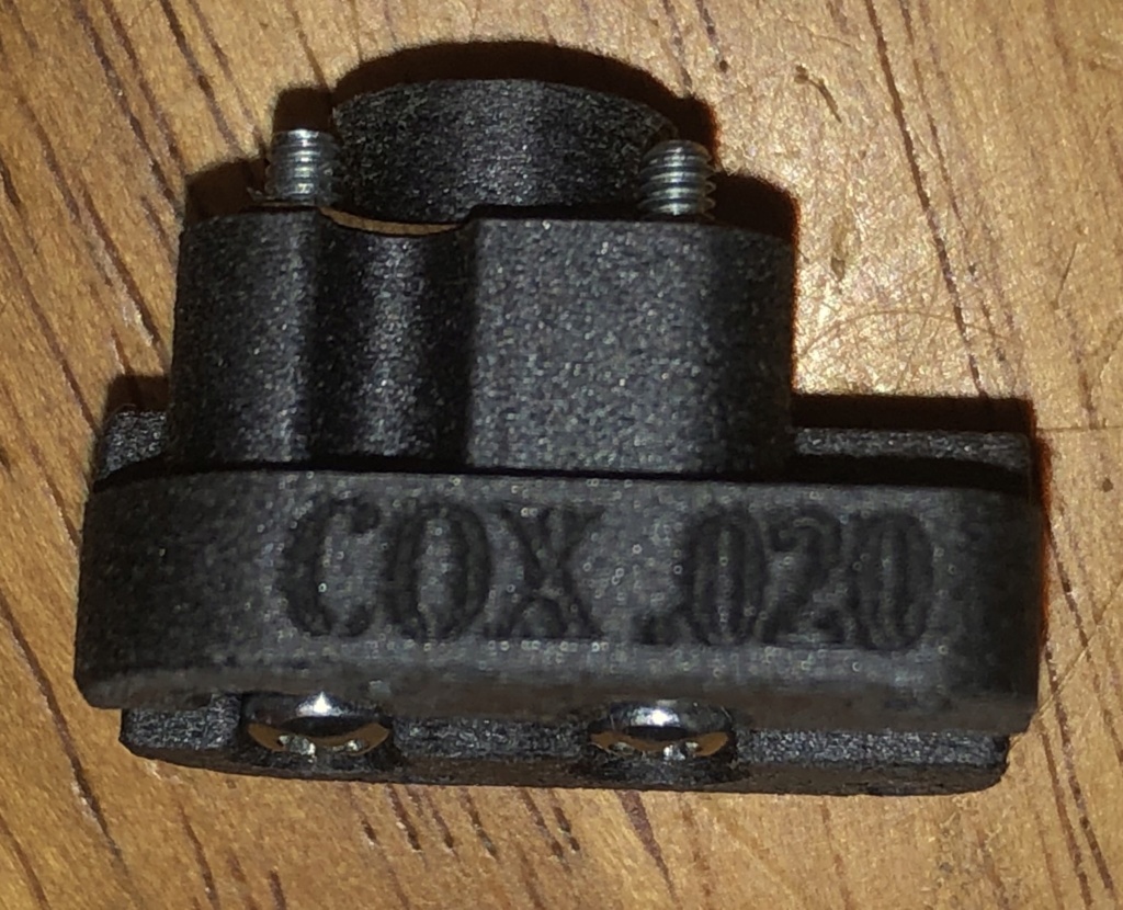

Exclusive CEF 2019 .020 Horseshoe Backplate
CEF .020 Horseshoe Backplate 5ac4f510
.020 front end and needle valve assembly not included, shown for demonstration purposes only
Ever wished you could mount your Pee Wee .020 like a Killer Bee or SureStart? Ever wanted to use an external tank for longer run times? Need another conversation piece (who doesn't)?
Designed and produced by longtime forum member Jason_WI (Jason Birnschein). More than seven months of development and testing. 3D printed from DuPont carbon fiber reinforced Zytel, withstanding temperatures up to 150°C. Each backplate was hand finished and carefully inspected.
Includes: reed, retainer, crankcase gasket, crankcase screws, and mounting screws. Does NOT include a needle valve assembly! Requires a 128 TPI needle valve assembly sourced from a .049 "postage stamp" backplate. For best results and the ease of tuning, using an 80 TPI needle valve assembly supplied with the SureStart and other horseshoe backplate product engines is not recommended.  Arrow Update: With further testing, a short stem 80 TPI needle did produce satisfactory results. See this post for more information: https://www.coxengineforum.com/t13351p25-cef-020-horseshoe-backplate#172040
Click on images to view larger
Note on needle valves: For the ease of tuning and best stability, a 128 TPI needle valve assembly will be desired. This must be supplied by the modeler and is not included with the backplate. These needle valves are most commonly found in early "postage stamp" product engines. Below is a picture showing the difference between a 80 TPI (right) and 128 TPI (left) needle.  Arrow Update: With further testing, a short stem 80 TPI needle did produce satisfactory results. See this post for more information: https://www.coxengineforum.com/t13351p25-cef-020-horseshoe-backplate#172040

Where will all the 128TPI needles be coming from lol; they are not an easy find and we ran out of stock a long time ago.
Will they really not work with the "Surestart" spraybars/needles? We have 1,000's of those spraybars and needles and could take at least 50 backplates (only the plastic part) as we have all the other bits. We also have lots of Babe Nee spraybars and needle valves.
Cox International
Cox International
Official Cox Dealer
Posts : 3266
Join date : 2011-08-08
Location : Williams Lake, BC, Canada
http://www.coxengines.com
SOLD! Re: CEF .020 Horseshoe Backplate
Post  Admin Fri Sep 20, 2019 3:18 pm
As of right now the buyers will have to extract the NVA from an old postage stamp backplate if they don't already happen to have any loose...
I haven't had a chance to do test runs for myself, but it appears that the engine becomes too "touchy" and difficult to tune when used with a 80 TPI needle. I'll let Jason answer this one.

This is the 80 TPI run video from the development thread of the backplate.
I wanted to see if it would run with an 80 TPI NVA from a sure start backplate. It runs but the needle setting is very touchy which is expected. Same prop and fuel as previous runs.
Post  Cox International Fri Sep 20, 2019 4:40 pm
Hm, not too bad ….
Perhaps a Babe Bee needle & spring will fare better? If you are interested, let's touch base next week to see if we can work something out.
Interestingly, we have OEM Cox drawings for a .020 Die Cast Surestart engine that Cox was working on but never went into production.
