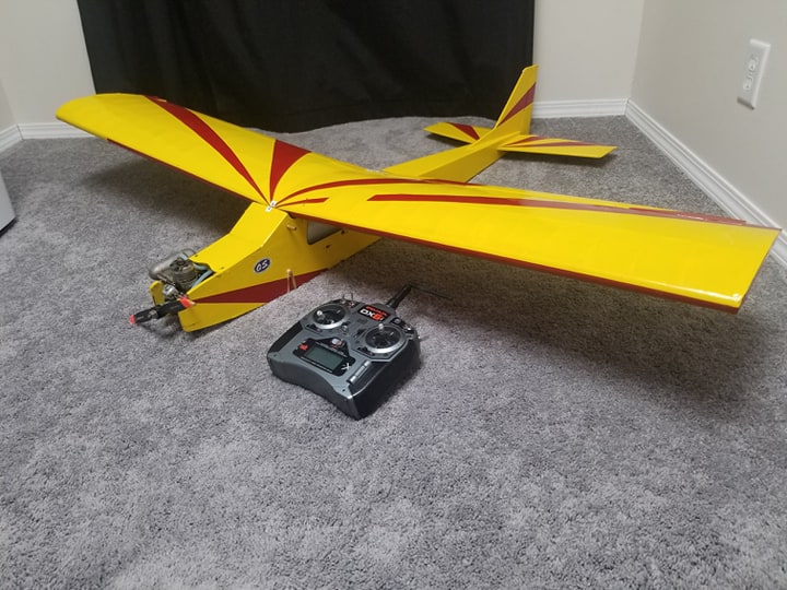

So, it has been a while now, and I got bitten by the bug again! It was approximately 26 years ago that I had started in the hobby. I had never made a successful nitro RC flight. 2 attempts with last second throttle down, followed by 2 flights in which I did take off. First ended up with broken mains that we quickly fixed, and the second was a total re-kitting of the airplane. Dad then bought me a Hobbico Sturdy Birdy II. Built it, never flew it!. This past summer, I attended a couple of rc airshows and said enough is enough! I had sold all my nitro RC engines a long time ago to buy small electric foamy stuff (micro servos, micro receivers, and such). Well, I had recently started to buy a couple used RC engines for my needs. But, I was still missing a plane! Talked to a buddy at work and he said he had a few trainers that need bits of work on them. So I bought one from him. Turns out to be a Top Flite Sierra .40 trainer. Nothing major to be repaired. A couple small cracks here and there, patch up the covering with some clear packing tape, clean, repair, re-inforce, and re-install the firewall. Had a Spektrum AR500 receiver, and got a few used S3003 Futabe servos to install. Landing gear is on its way to me and should have it next week. Fixed up the broken engine/nose wheel mount. As for engine..... I will be flying an old Enya .35 RC (Model 5224) engine in it with strap on muffler. Hopefully it will haul this bird up. The only problem I had encountered with the engine was a small chip missing on the top of teh exhaust flange that I had used JB weld to fix, and the fact the needle was too short to turn when in the plane. That I solved with a small piece of dowel with hole in the center for the nub on the tip of the needle. Once I got that I used a piece of heat shrink and seems to be holding out just fine! So once I get the landing gear and install it, I will update my progress. With winter type weather quickly approaching, I may not have a chance to try flying this year. Either way, my plane will not take to teh skies as the club I will be joining has a club trainer to learn on. Here are a couple of pictures the way it sits.

Nice airplane Chancey, Reminds me of a Falcon 56 and my Sterling Fledgling. You ought to be able to float that plane around the air quite well. Not much work there to be done and I like the covering scheme.
Curious about the Enya .35 though. I don't recognize the number. Is it marked just 35 or is it a II or V? In .35 they made early versions 5001 and 6001, then 5224 (shared with the .29) and the 35V 5225.

Nice looking trainer Chancey , Is the engine broken in ? Don't feel bad i have a plane i built over 20 years ago and still havent put it in the air , has a brand new OS 40 on it .

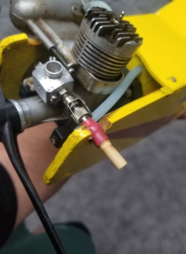

I had run about 2 - 4 ounce tanks through it, and it seemed to run nicely and steady. That is when I ran out of fuel at the lake so I had to stop. Also to note, after running it there, I brought it home and noticed a small bit of silicon on the top of the exhaust area that I wanted to clean off. So, I pulled it off and it did come off nicely, only to find that there was a small 'chunk' taken out of the upper exhaust flange/mating area. So, I cleaned teh area with alcohol good then used my Dremel with a stone to rough up the surface. Cleaned it with alcohol again and with an aluminium tape backing I filled teh area with JB Weld. Let it sit a day then carefully filed the JB away where it did not need to be, and also filed the mating surface very close to even. I then used 220 grit sandpaper on my sanding bar to make it smooth and flush using a Sharpie marker as a guide. I also did the same sanding to the 'rough' muffler. After all was said and done, I cleaned it one last time and applied a single layer of the tin tape to the engine, trimmed it to fit and will use that as a 'gasket' to seal it in case of any minor imperfections. Area that was fixed is circled in red. I hope it holds, but if not, I am not too concerned as it did run well before the repair.

That's a common fault and repair on Enya engines Chancey. I have done several as you describe and a couple more left to do. I don't know if it's just Enyas that are susceptible to this or not, perhaps because I have so many of them the odds are that I will find a few.
Maybe their cases are just brittle, but none of my other engines suffer from that sort of damage.
