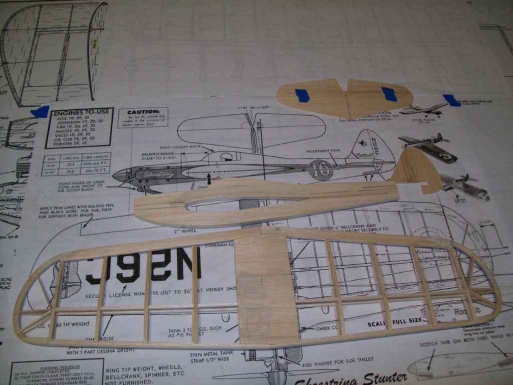

Here's another project that I think turned out pretty well. I had decided to build a Lil Jumpin Bean, and was reading the posts about the plane here. Someone mentioned that it was basically a half size rendition of the Goldberg Shoestring. Well, I printed the Shoestring plans at 50%, and the wing was an exact match. The Bean's tailfeathers were slightly bigger. So, I went ahead and cut a fuselage and vertical tail from the Shoestring palns, and a horiz. tail & wing ribs from the Bean. I did change the wing structure to make it build lighter.

Well done duaneh. Nice looking build. I must mention, I always wondered about having the engine set off the centreline of the fuse. With it outboard, I always suspected that the plane would come in to the circle due to greater drag inboard of the thrust line. Since yours flies so well it seems it may not matter as much as I thought.

Rod, I was a bit concerned about the offset thrust line myself, but I have seen this technique used successfully before. In this case, I wanted to preserve the forward fuselage and cheek cowl.This seemed like the best way. Also, there is no right thrust used. I knew the sleeve launch would tell the story, as it puts the model in midair with zero airspeed. I needn't have worried, as it accelerated straight forward, losing maybe a foot of altitude in the process.

Duane, I love it! And it never occurred to me that the Bean is a baby SS, but you nailed it. I also agree with your decision to go with the Bean's bigger stab. And I like Tico's idea that a Medallion would be a perfect match for the airframe.
