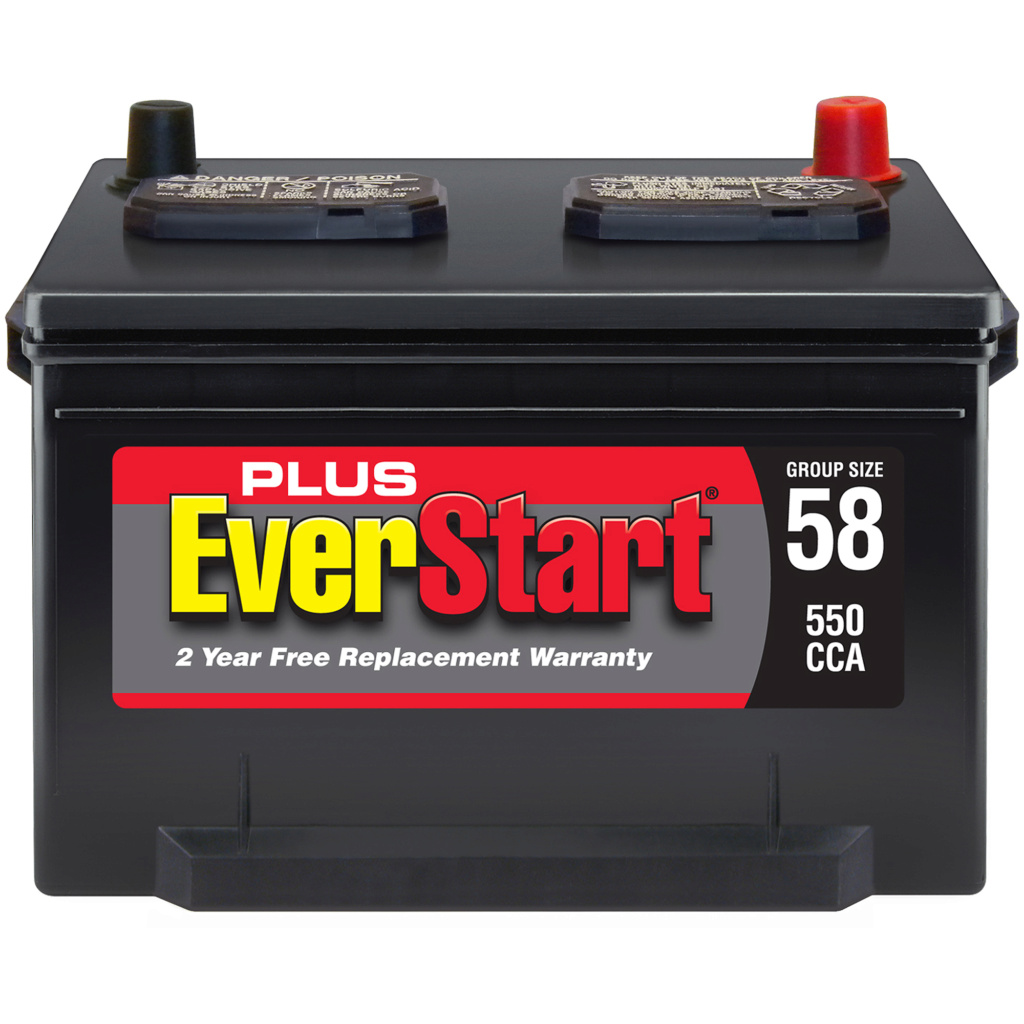

Re: Car Batteries
Wow.. cool thread here.
Most of you probably know what a "Swan-style" disconnect is..
Here's a pic;
At approx. $10.00 (USD) the Swan disconnect allows just that; disconnecting your battery from whatever it's connected to, with a simple twist of a knob. If installed in your vehicle and "switched-off".. the battery is completely isolated from whatever it's connected to. You "can" however connect a battery charger/maintainer in the conventional way.. if desired.
It should be mentioned.. that disconnection from a modern motor-vehicle harness will require resetting any preset radio stations.. as well as some other functions.. such as would be necessary if changing/swapping-out the battery itself.
The Swan disconnect could come in handy "if" as has been stated by others here; their vehicle's electric system encounters a "drain" from an unknown source.. which depletes the main battery from being able to start the engine. Tracing a dead-short in your average 12V neg. grounded automotive electrical system can run into several hours of shop-labor.. at their hourly rate.. So.. it may be more economical to raise the bonnet.. and turn a knob.. and manually tune the radio station.. until it's time to spend the $$ to trace the short.
Back to Car Batteries.. the "Ever Start" (Walmart brand) has actually been highly rated.

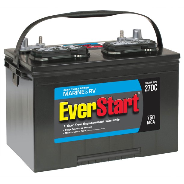

I purchased an "Ever Start" Marine (deep-cycle) battery several (10?) years ago, for the soul purpose of providing 12VDC for inverters (12VDC "in" 110VAC "out") for when we lose power here at home. I typically power-up the CATV router.. and check for a signal. Most often I've found that the data lines are uninterrupted. The LED light-bulbs are great in this scenario.. because an average room can be lit using one table lamp.. at far less wattage than the tungsten lamps that they've replaced. This reserves power for operating/receiving broadcast radio/TV news updates.. not to mention powering-up a home office.. if need be.
My Deep-cycle battery is similar to the one pictured below;
