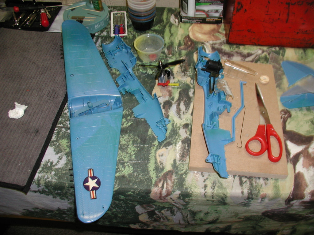

Not with a lot of hope for success I took a shot at this thing this morning.  No way those spinners were going to loosen without heat.
W/M P-38 in the emergency room, prognosis.............  P1013282
Staying cautious, least aggressive approach I used 91% alcohol to begin clean-up.
W/M P-38 in the emergency room, prognosis.............  P1013284
W/M P-38 in the emergency room, prognosis.............  P1013283
W/M P-38 in the emergency room, prognosis.............  P1013285
Moving on to the body, I found the mounting screws buried 3/4" into the fuselage, no way I was going to get a soldering iron in there without distorting the plastic.
So, just to see, I used my best screwdriver and got movement.  Not that snap that indicates a broken screw or post but a nice slow release.  Those here that have delt with these castor locked screws know what I mean.  But the body is cleaning up nicely with only alcohol and it looks like it will actually come apart without max grief.
W/M P-38 in the emergency room, prognosis.............  P1013286
As far as I'm going for now.  Still dealing with this.  Not so simple, two canopies, an engine, bell-crank, tail hook, pilot eject spring, fuel tank, tail wheel and tail assembly all have to be put together as one.  Two hands only are not hacking it.

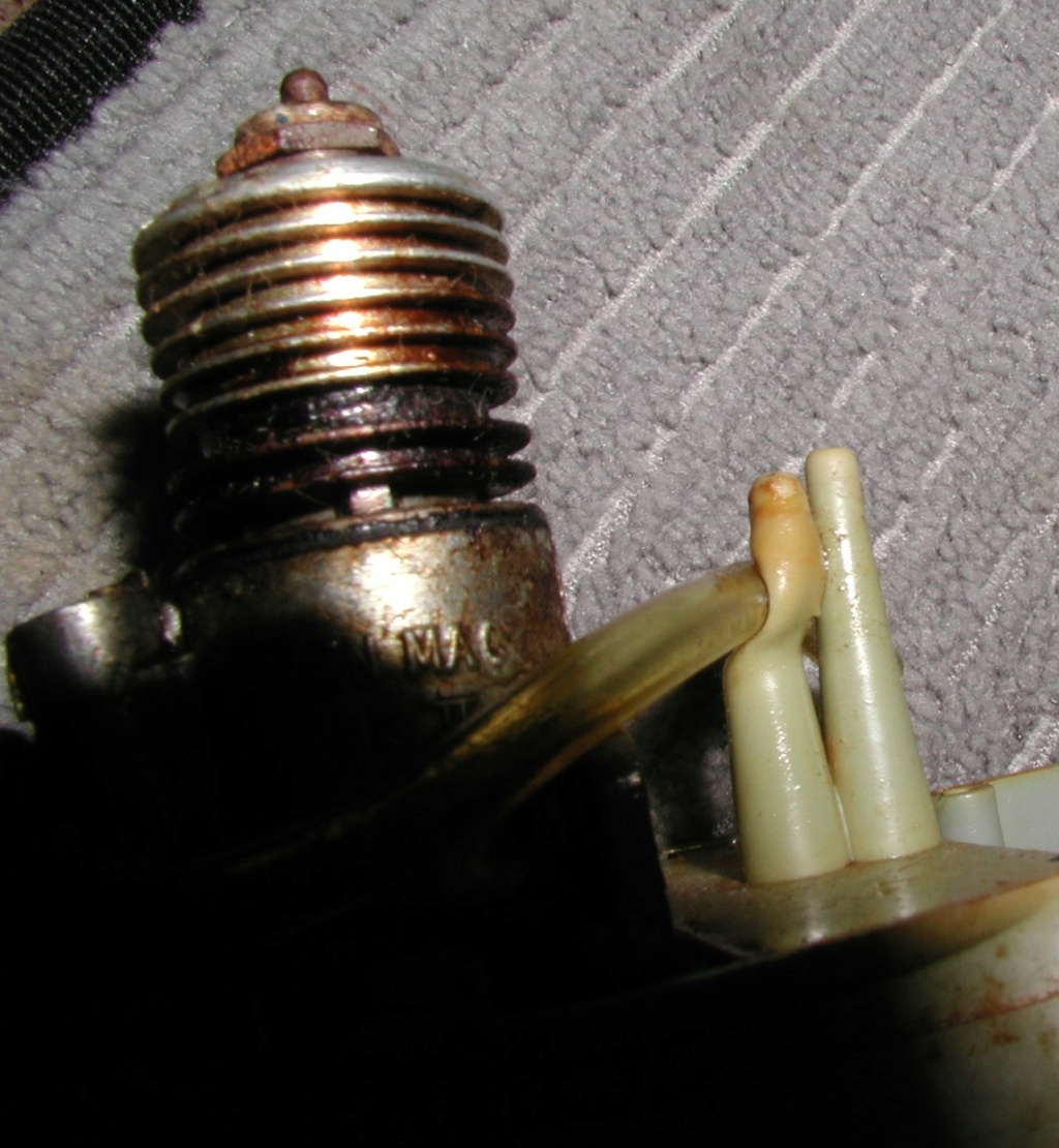

Amazing, came apart without difficulty unusual for these.  No heat, no broken posts no buggered up screw heads.  I needed an exacto blade to separate the fuselage sections but that's it.
W/M P-38 in the emergency room, prognosis.............  P1013292
Broken fuel tank nipple.

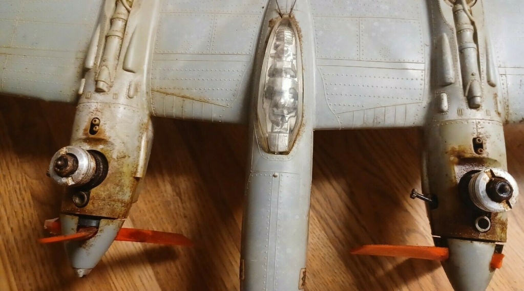

Started cleaning up the worst engine nacelle first.  Alcohol and a soft cloth only.  Fuel and castor sucks the finish out of plastic, Howards wax to some extent restores it. Cleaned up one side.
W/M P-38 in the emergency room, prognosis.............  P1013296
W/M P-38 in the emergency room, prognosis.............  P1013297
Engines tomorrow.

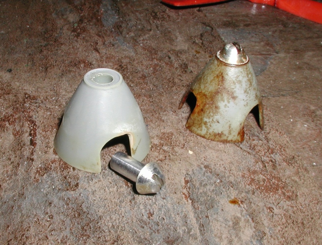

About the easiest, quickest clean-up that I have had to date.  Surprised, I was ready for a war.
W/M P-38 in the emergency room, prognosis.............  Wm_p-314
W/M P-38 in the emergency room, prognosis.............  P-38_e10
W/M P-38 in the emergency room, prognosis.............  P1013301
W/M P-38 in the emergency room, prognosis.............  P1013300
I decided to keep the broken props.  Adds character and symbolizes what was probably it's last flight.  I have stars and bars decals for it.  Both engines are fine, starters work and they flip over with authority.  Still needs a little massaging, but mostly it's done.

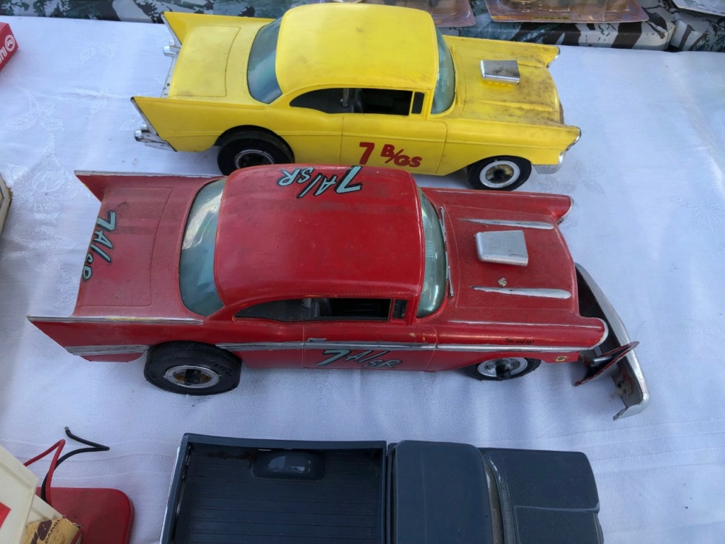

It came bundled with an all red tether car 1957 Chevrolet Impala with the high fin tails and large rear slick tires, similar to this.
W/M P-38 in the emergency room, prognosis.............  2022-037
E-Bay photo.
The Wen-Mac had a modern glow head instead of a glow plug. Engine was shared between both. One removed the prop and nut, installed a pinion gear with flywheel. I don't remember any heat sinks in car mode. The pinion mated with a larger gear on the single axle that drove both rear wheels. My impressions of the engine was Babe Bee like power.
As simple as it was, the fact the Corsair was all chrome made it look very impressive.

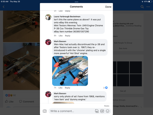

Yes, Testors version of the Wen Mac after they merged. Left engine is real, right side engine is a dummy. Mentioned it to George some time ago.
Bob, yes, you mentioned to me about the later version. However, I looked close at the photos that @ctatman pointed out in his E-Bay link.
What I see is two engines. The left one appears to be the original with shorter machined steel needle.
W/M P-38 in the emergency room, prognosis.............  2022-038
The right, is a Testor's McCoy .049 Red Head engine with cable style needle valve. It is certainly not a dummy engine.
W/M P-38 in the emergency room, prognosis.............  2022-039
Both photos, left engine and right engine show the fuel tank nipples in molded white plastic visible behind the engine.
What I gather is, there is a possibility that perhaps someone had upgraded this very low time or non-running P-38 by replacing the dummy engine with a real engine. Perhaps in the single engine version, Testor did not make any other changes except to mold a dummy engine that bolted in exactly like the original? Rather than retooling to eliminate tank for right engine, made no changes?
