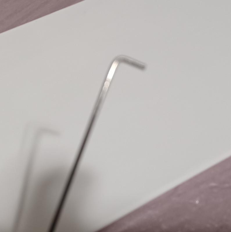

I’ve been trying to find my Z-bend pliers for months now, but everywhere I’ve looked didn’t turn them up.  This past Sunday I got volunteered to make seven Skyray kits for a club 1/2A day One-Design contest.  So I really need to make up some Z-bends.  So, I had to go old school again and make up a set of substitute pliers the old way.
I took a cheap pair of flat nosed pliers from Harbor Freight to make them.  A wider pair would be better, but it’s what I had.  Since I’m going Old Skool, I pulled out my 30 year old, single speed Dremel tool and cut a slot in one of the tips big enough for a wire to stick through.
Going Old School again 20230119-220414
Going Old School again 20230119-220515
Then I took a piece of piano wire and bent the end.  Sorry for the fuzzy pics.  Next I put the wire through the slot I cut and bent the wire down.

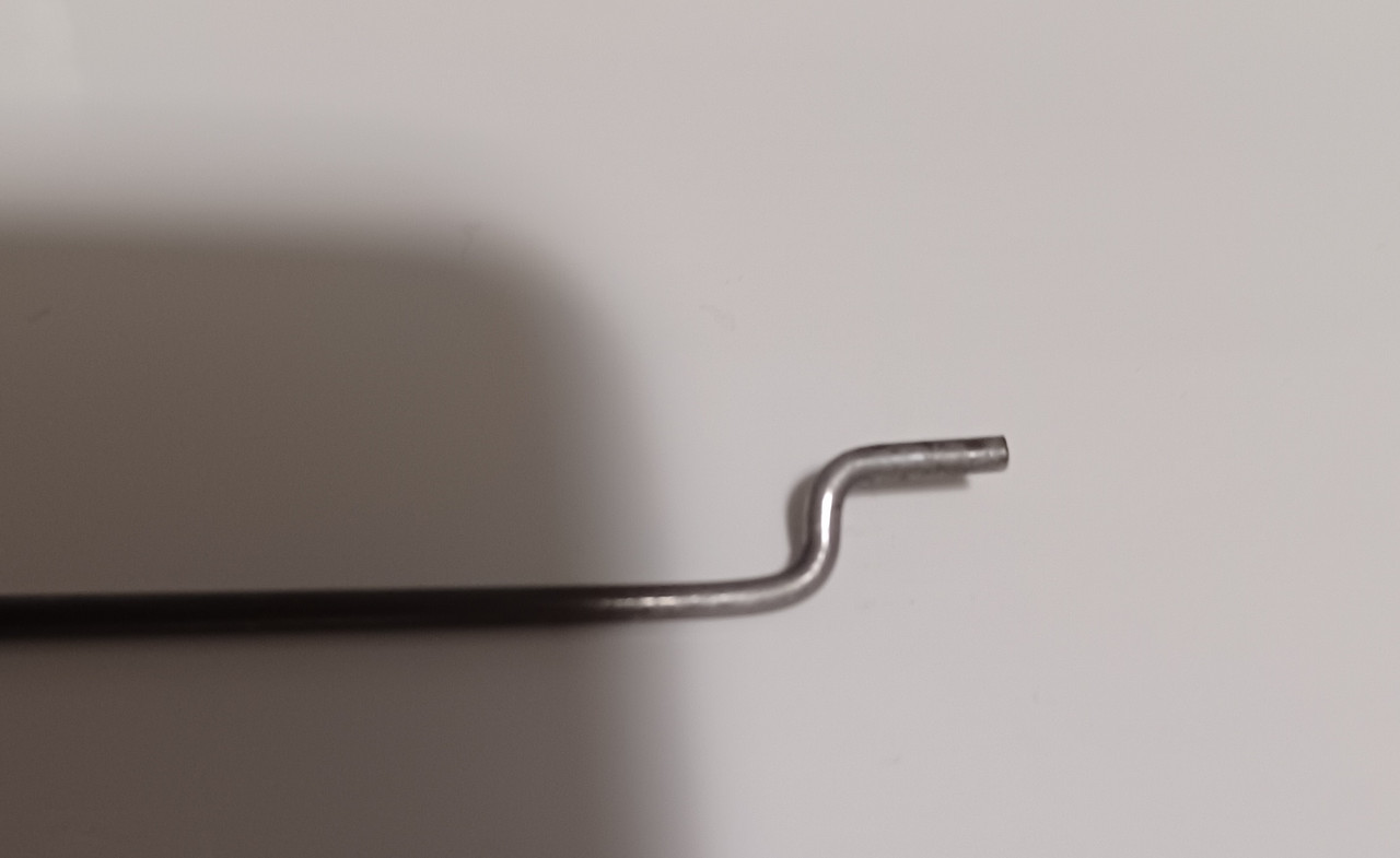

Voila! A Z-bend!  Not as neat as with the Z-bend pliers, but more than serviceable.
