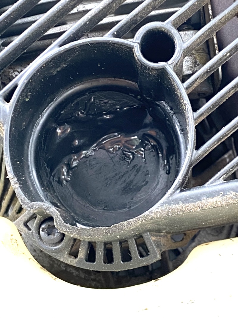

Cheapie Murray from WM about four years old….. Started losing power and getting hard to start so I decided to look into it…. Just a big model airplane motor right?….Spark, Fuel good so kept digging….Pulled the plastic backplate off to look inside….. Found it to be the backplate itself….. Crank pin had cut a grove and ultimately all the way thru ….
Another thing I found odd is that the crank pin is free to float, Not fixed to the crankshaft….Also that the crank pin has chamfered ends that are practically a sharp edge that could meet the backplate
So I covered up the hole with JB weld and rounded the end of the crank pin in the drill press to hopefully keep from digging in further….and got the power and ease of starting restored…. I’ve since found where I could order the back plate (cheap) so I’ll get another and keep this cheapie trimmer going for awhile….. Thought my fellow “engine guys “ might like to see this….

I'd be very dubious about making a JB Weld repair inside the crankcase. Just needs a small chunk to come free and shoot up the bypass, lodges in the port and rips a hole down the side of your piston. If a new backplate is still available I'd be doing that. I think the current repair will be very temporary and the results of a failure devastating.
Rod.
Rod.
Thanks for the heads up Rod, It’s repaired from the outside, I should have noted that….. I will still order the new part because of the groove worn in the old one…. But would be a neat experiment to see how long the patch would hold up to the heat and oil…
