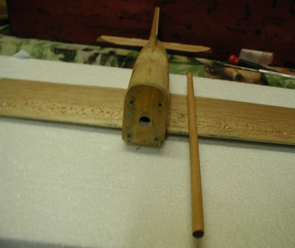

Post  rsv1cox Sat Jul 29, 2023 4:12 pm
In stages.
Wondering if this was built by a kid or an adult. Signs of both. Curious base, peels off like plastic wrap. Some sort of sanding sealer perhaps but it didn't act like it. Cox engine came with a surprise. Had a canopy at one time, pinned on.

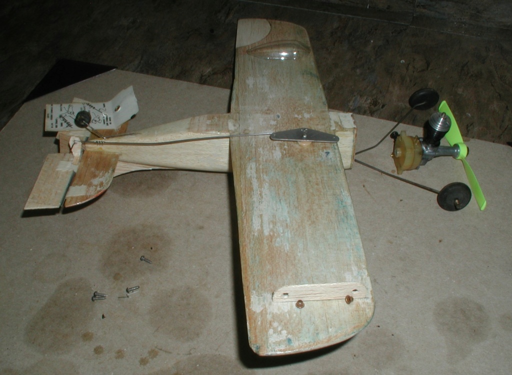

The wing on the orange plane is on backwards, it is also airfoiled making for some interesting flight characteristics.  Also the bell crank is way out of position.  Might explain why the tail section is all beatup.  But I agree George, it would fly but not very well.  Maybe in Ken's hands.
The Scientific Walt Musciano "Red Devil"? and the stepped Cox Babe Bee Orange12
The Scientific Walt Musciano "Red Devil"? and the stepped Cox Babe Bee P1015829
The Scientific Walt Musciano "Red Devil"? and the stepped Cox Babe Bee Oplane10
The Scientific Walt Musciano "Red Devil"? and the stepped Cox Babe Bee P1015830

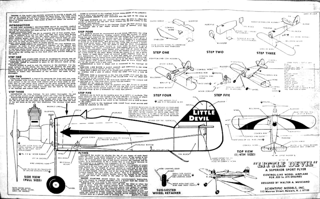

Original Little Devil by Walt Musciano.
The Scientific Walt Musciano "Red Devil"? and the stepped Cox Babe Bee 18in_l11
Later Little Devil design by Walt Musciano.
Posts : 4925
The Scientific Walt Musciano "Red Devil"? and the stepped Cox Babe Bee Empty Re: The Scientific Walt Musciano "Red Devil"? and the stepped Cox Babe Bee
Post  rsv1cox Mon Jul 31, 2023 6:48 pm
Thanks George for that, been looking for it. Printed it out. Good old Walt.

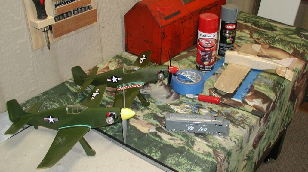

While the RX-7 sits neglected (actually I could have it running in about an hour - but it's hot out there) I search ebay for interesting stuff.  Found this original boxed Scientific P-40 like I used to buy in the 1950's.  Seller had it priced and a BIN, made a low-ball offer which was accepted.  Eager to get this one.  While Black Hawk models are nice, they are no substitute for the real thing.
The Scientific Walt Musciano "Red Devil"? and the stepped Cox Babe Bee P-40_b10

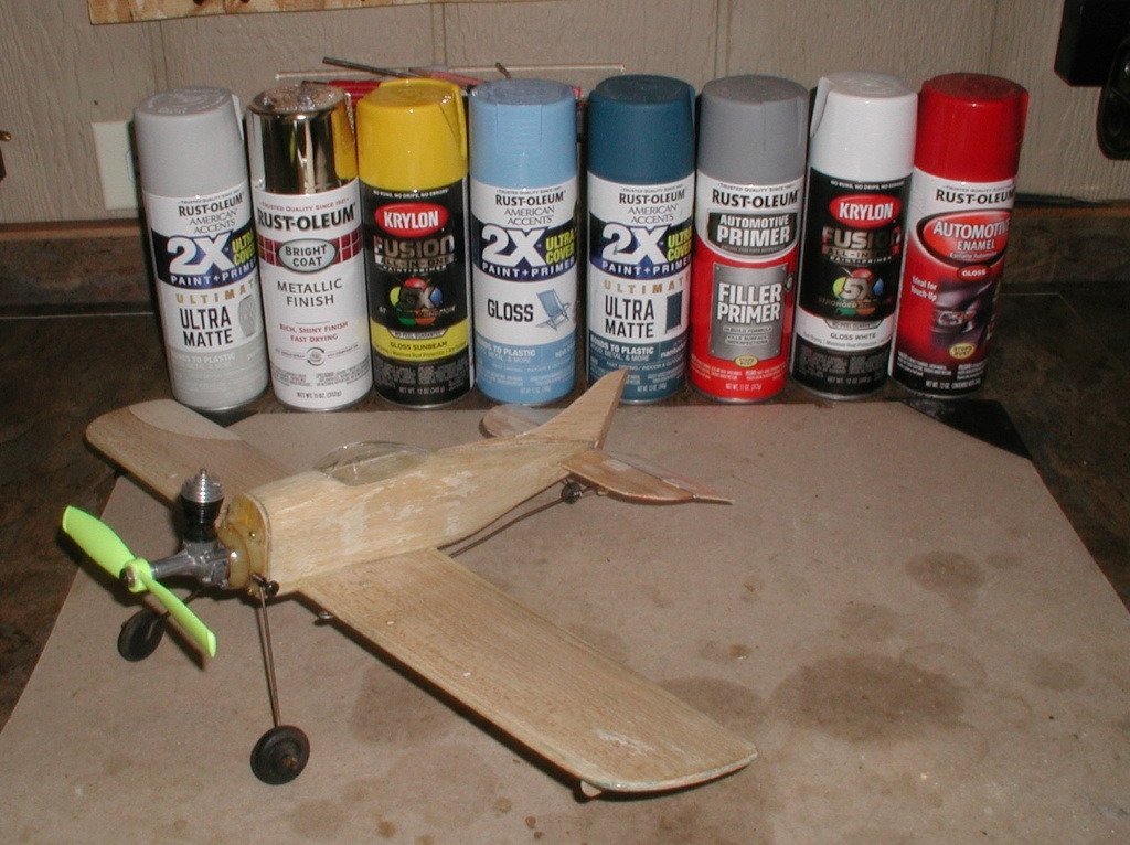

Push has come to shove and this thing is saying "Finish me!"
But this is where I fall down. I'm ok on military - normally olive drab, silver, yellow, various shades of blue; and established makes where the paint schemes have already been applied. But these drempt-up models have no guide other than box art, which varies. So, mostly left up to the builder. Not a strong point for me!
I'm still leaning to Red/White (Walt's Red Devil) but I love that matte blue, and silver always calls. Any ideas?
The Scientific Walt Musciano "Red Devil"? and the stepped Cox Babe Bee P1015863
The Scientific Walt Musciano "Red Devil"? and the stepped Cox Babe Bee P1015864
Or, I could just spray it clear showing off all the watts and imperfections. Decisions........
