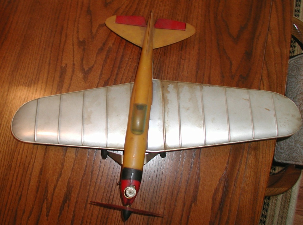

Post  rsv1cox Sun Aug 13, 2023 9:05 am
Combination of poor packing and USPS handling, but I have received worse, much worse.
One end of box left open and not properly sealed, happened to be the spot that got hit. When the fuselage got pushed one of the four fuselage locating pins caught the fuselage and cracked it.

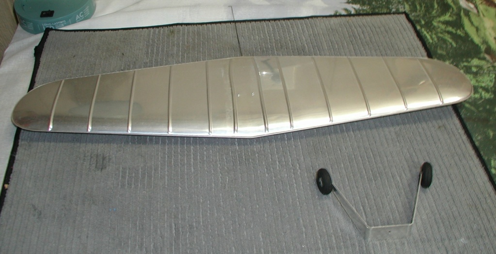

Thanks guys, I think I can make the crack less obvious, the wing thankfully is fine.

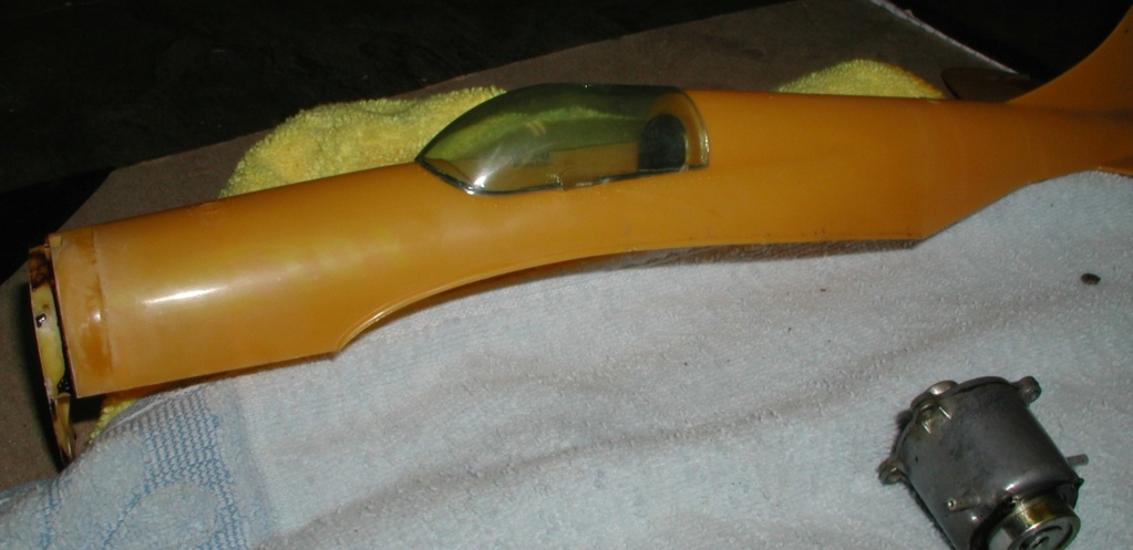

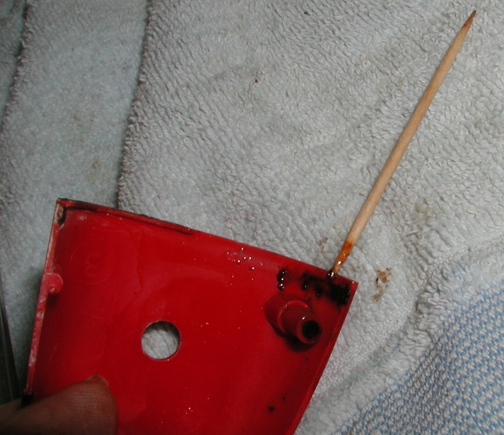

Quick progress, repaired from the inside. Testors Red Tube wicked into the crack, cured overnight.  Hardly visible now.
USPS delivers Cox TD-1 bent and cracked. Cracke10
USPS delivers Cox TD-1 bent and cracked. P1015906
USPS delivers Cox TD-1 bent and cracked. P1015907
USPS delivers Cox TD-1 bent and cracked. P1015909
USPS delivers Cox TD-1 bent and cracked. P1015908
Deep story on this one, odd if interesting structure.  What a difference between this early Cox effort and later ones. Reading about them is one thing, hands on a different story.
More later.

Hardly visible? Totally invisible, at least to me through my glasses, but I am sure very few of us will tell where that nasty crack was..congrats, Bob, your salvation results are always superb..

Thanks Andras, glory goes to the Testors Red Tube it has pulled my bacon out of the fire many times.

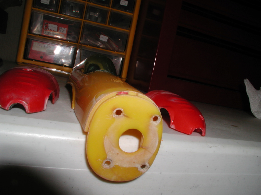

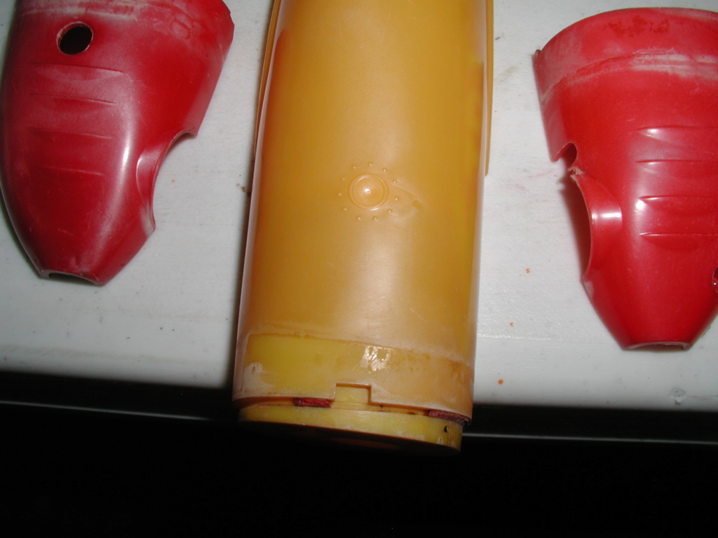

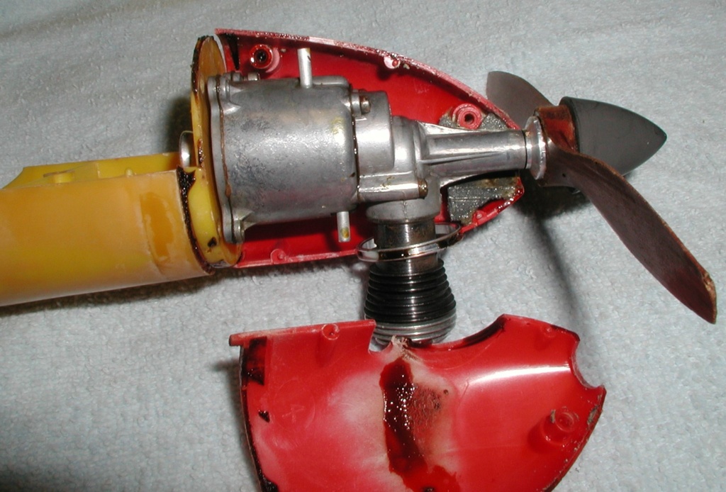

Post  rsv1cox Mon Aug 14, 2023 8:10 am
getback wrote:Like was said glad it was no worst than that , repair looks great and about that story > Popcorn
I was worried about that electrical tape, a cracked cowling is difficult to repair.
My theory is that he flew it and broke the original Cox propeller and separated the cowl at the seam.  Took it apart and lost one of the cowl screws and taped it back together.  Replaced the propeller with the wooden one and flew it several more times which filled the open screw hole with castor goo.  Took a toothpick and alcohol to dig it out.  At first I thought the screw had broken off in the hole, not a good thing...........
USPS delivers Cox TD-1 bent and cracked. P1015910
Whole thing a gooey mess, about normal for these.
USPS delivers Cox TD-1 bent and cracked. P1015911
USPS delivers Cox TD-1 bent and cracked. P1015913

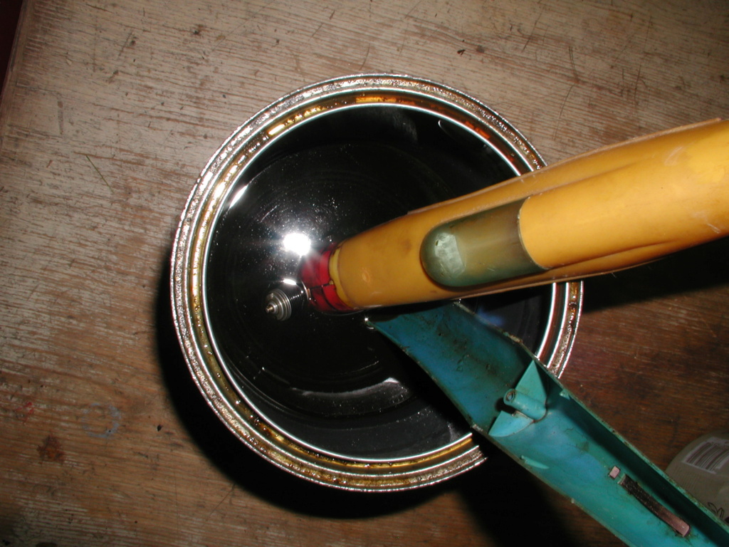

Dumped in Berrymans for about 10 minutes, small paint brush brush over, Simple Green, water rinse.
USPS delivers Cox TD-1 bent and cracked. P1015912

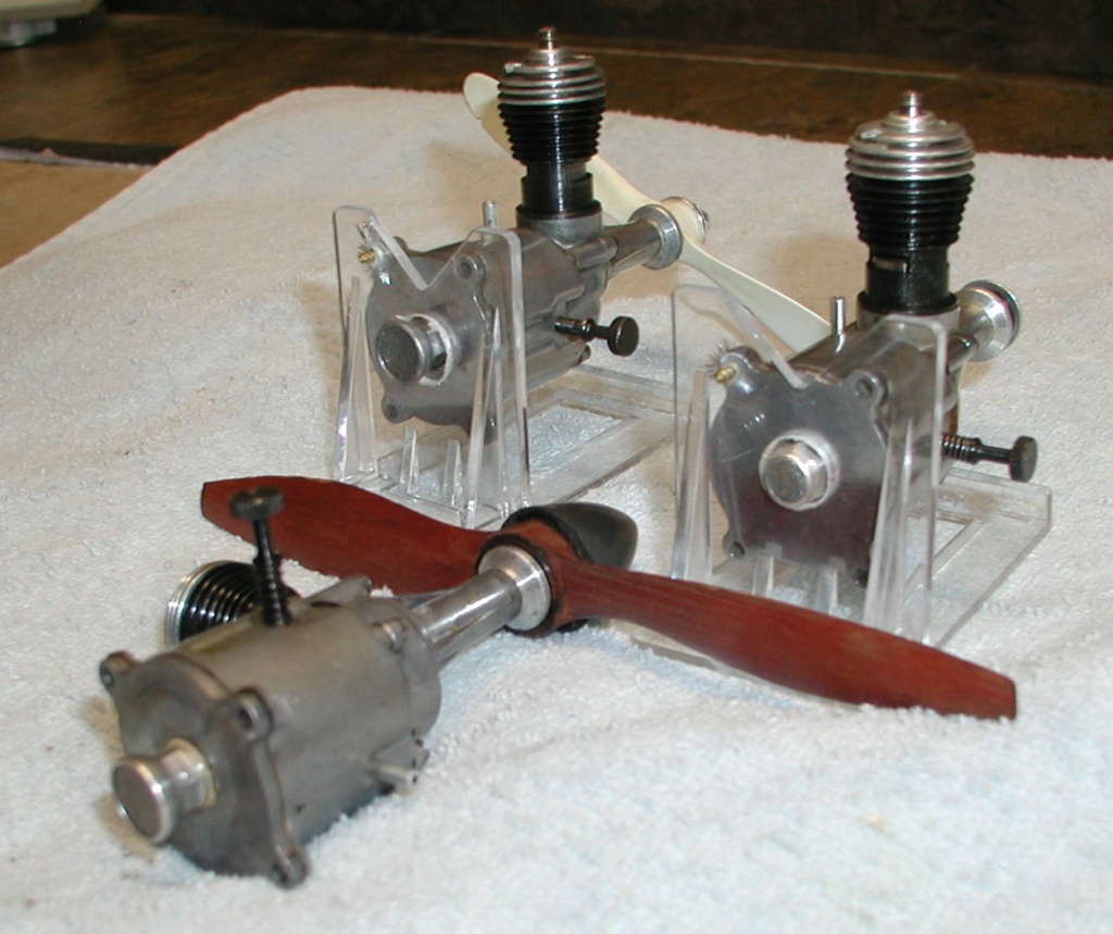

Post  rsv1cox Mon Aug 14, 2023 6:21 pm
USPS delivers Cox TD-1 bent and cracked. P1015928
From the AMA text:
The Space Bug engine was quite a remarkable advance in engine design. It had a compact cast
aluminum crankcase fastened to a rather large cast aluminum gas tank. The tank held a reedvalve fuel induction system and was radial-mounted to the firewall by four screws. The pistonconnecting rod was ball and socket rather than having a wrist pin. The most amazing feature was
the steel cylinder-piston combo that was machined to fantastically close tolerances. Instead of a
glow plug, it had an aluminum glow head with a built-in glow coil of his design.
By 1953, he was selling three different versions of the Thimble Drome engine. The Space Bug
sold for $6.95. By demand, the heavy tank was removed for the modelers and it was called the
Thermal Hopper for $6.95. Then Space Bug Junior with a plastic tank for $3.95. The first engine
review in Model Airplane News magazine was in May 1953 on page 29. This sparked a new
wave of enthusiasts.

Post  rsv1cox Tue Aug 15, 2023 10:37 am
NEW222 wrote:Have to agree about the repair. Can't even see it after! Great job.
Do you fill the crack and 'scrape' off anything on the outside after, or just wipe off excess before it dries? I just remember using the stuff many moons ago on my plastic models I used to build. Dang I made a mess everywhere.....
Easiest repair that I have ever made of this severity. A little finger manipulation and it just snapped into place. You could hear it. Then I just twisted it a bit from the inside which opened the crack and covered it with Testors wicking it into the crack. None of it came through on the outside. I just got lucky, not always my case.
Somehow I think I'm really going to screw up this wing. The aluminum is stained beyond the hot castor. I'm going to try Berrymans, it works wonders on Cox aluminum cases returning them to like-new condition. Maybe the same for the wing.
The bell crank and leadouts are all self contained inside the wing, something goes wrong and there is no repair. The pivot for the bell crank is one of the fuselage locating pins and the wing is crimp sealed all the way around the perimeter.

Post  rsv1cox Tue Aug 15, 2023 7:01 pm
Throwing away caution - "If it works, it works if it doesn't, it doesn't" I coated one half of the wing with Berryman's and let it sit for about seven minutes.  Sprayed it with Simple Green to neutralize the Berrymans and immersed it in water wiping it with a microfiber towel while still wet.  I was amazed, gave me the as manufactured look that I wanted.  Finished the rest of the wing and the landing gear in the same way.
USPS delivers Cox TD-1 bent and cracked. P1015933
USPS delivers Cox TD-1 bent and cracked. P1015932
Photos show shadows that are not there.
USPS delivers Cox TD-1 bent and cracked. P1015931
USPS delivers Cox TD-1 bent and cracked. P1015930
I haven't forgotten about The Red Devil.

Post  pman1111 Tue Aug 15, 2023 7:52 pm
Had a feeling the Berryman's might work, wasn't sure the best way to accomplish the application, but it looks like you nailed it! That stuff sure does a good job on aluminum engine parts, the trick I learned the hard way is to not let it soak too long.

Post  rsv1cox Wed Aug 16, 2023 9:01 am
pman1111 wrote:Had a feeling the Berryman's might work, wasn't sure the best way to accomplish the application, but it looks like you nailed it! That stuff sure does a good job on aluminum engine parts, the trick I learned the hard way is to not let it soak too long.
              Don
Thanks Don for the suggestion, it really hadn't crossed my mind until you mentioned it.   Then I remembered how well it works on Cox cases.  It's the best part of the model and the part that worried me the most.  Completed except for the propeller, I haven't settled on that one yet.
Wing is clean and universal in apperance, what you see are reflections.  The wing is just as it came out of the Berrymans, Simple Green, and water rinse, no polishes.
USPS delivers Cox TD-1 bent and cracked. P1015935
USPS delivers Cox TD-1 bent and cracked. Ebay_t11
The seller refunded me $50, what I had asked for.  I told him to go to the local post office and file a claim using my description and pictures.  Makes the cost for it less than $100.
Missing cowl screw was a 2/56.  I just cut another one to length.
