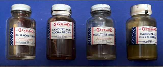

I bought this because I liked the box art and it’s a p 40 , when I opened it up it looked untouched. The little note leads me to be leave this came out during  WW II . It looks brand new but the dope has hardened over time . Anyone have an idea how I can clean out the jars ? Thanks for any help

Very good buying Very Happy Interesting to read WW2 label.
Filling jars with cellulosic thinners and waiting several days is OK to clean them.

Post  HalfaDave Mon Aug 14, 2023 12:52 pm
Hi akjgardener,
I learned this tech from CP here...Cool
Strap the bottles on the business end an orbital sander. (with tape)
Add any thinner, you think...
It is a 'coarse' ultrasonic cleaning method that works great.Cool
I bet you can save the labels with careful Duct taping... Smile
I have a glass bottle that fits on my 'orbital sander',  that has cleaned allot of [bleep] ! Laughing
Thanks CP, Cool
Take care,
Have fun,
Dave

Re: The dope issue, sometime back I cleaned 4 oz. SIG dope bottles that dried by filling with some Acetone and soaking a couple days. It softened it enough that I could clean the bottles totally. sifted out the softened paint globs and reused for another bottle to clean.

Thanks George , I’ve got plenty of acetone . I might have trouble getting the old caps off. I might try to heat them

Acetone or lacquer thinner. Scape/transfer as much as you can into a clean 4 ounce bottle...then do this with the bottle of goo. Wait a while while the machine does all the hard work.
