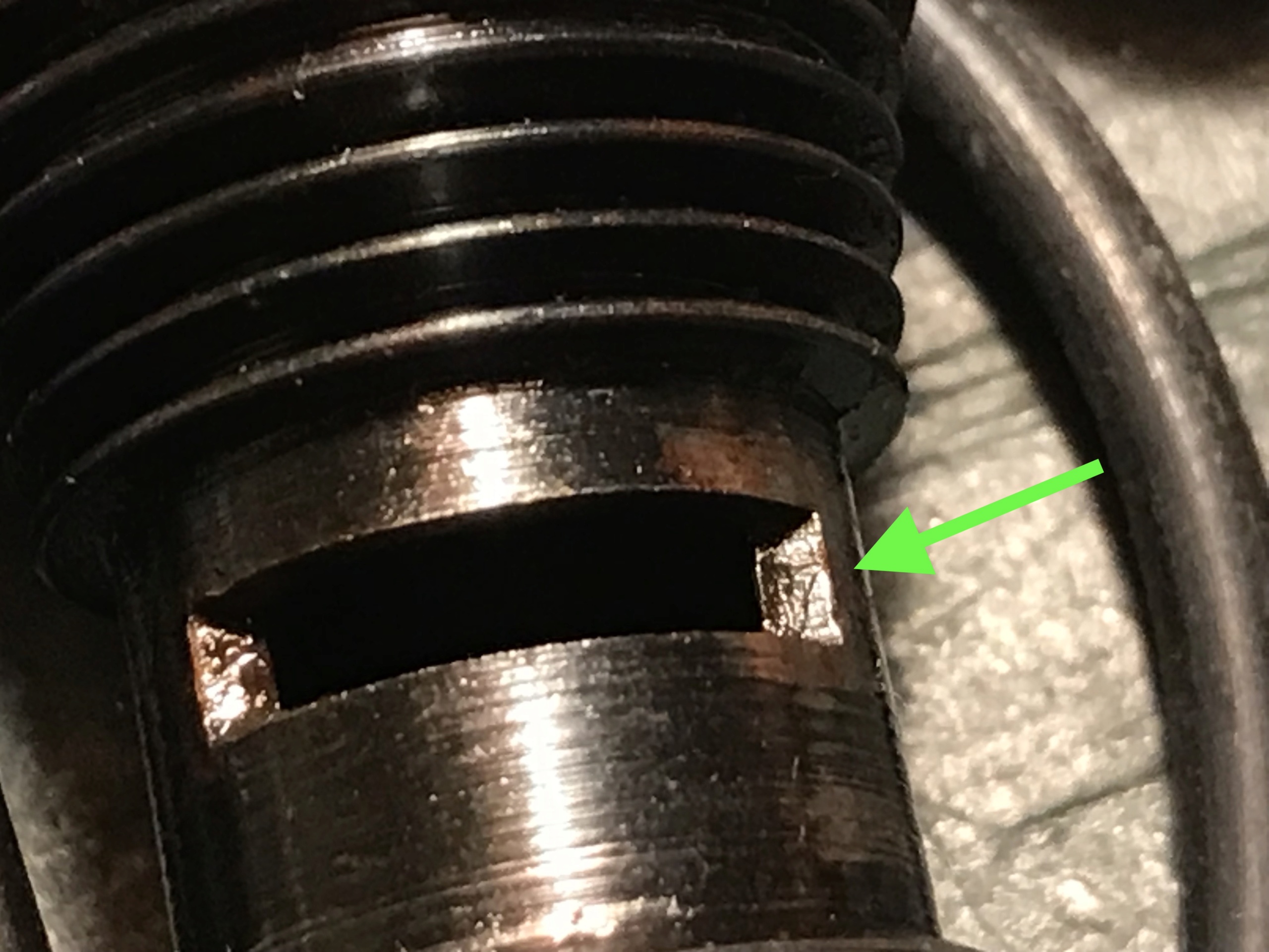

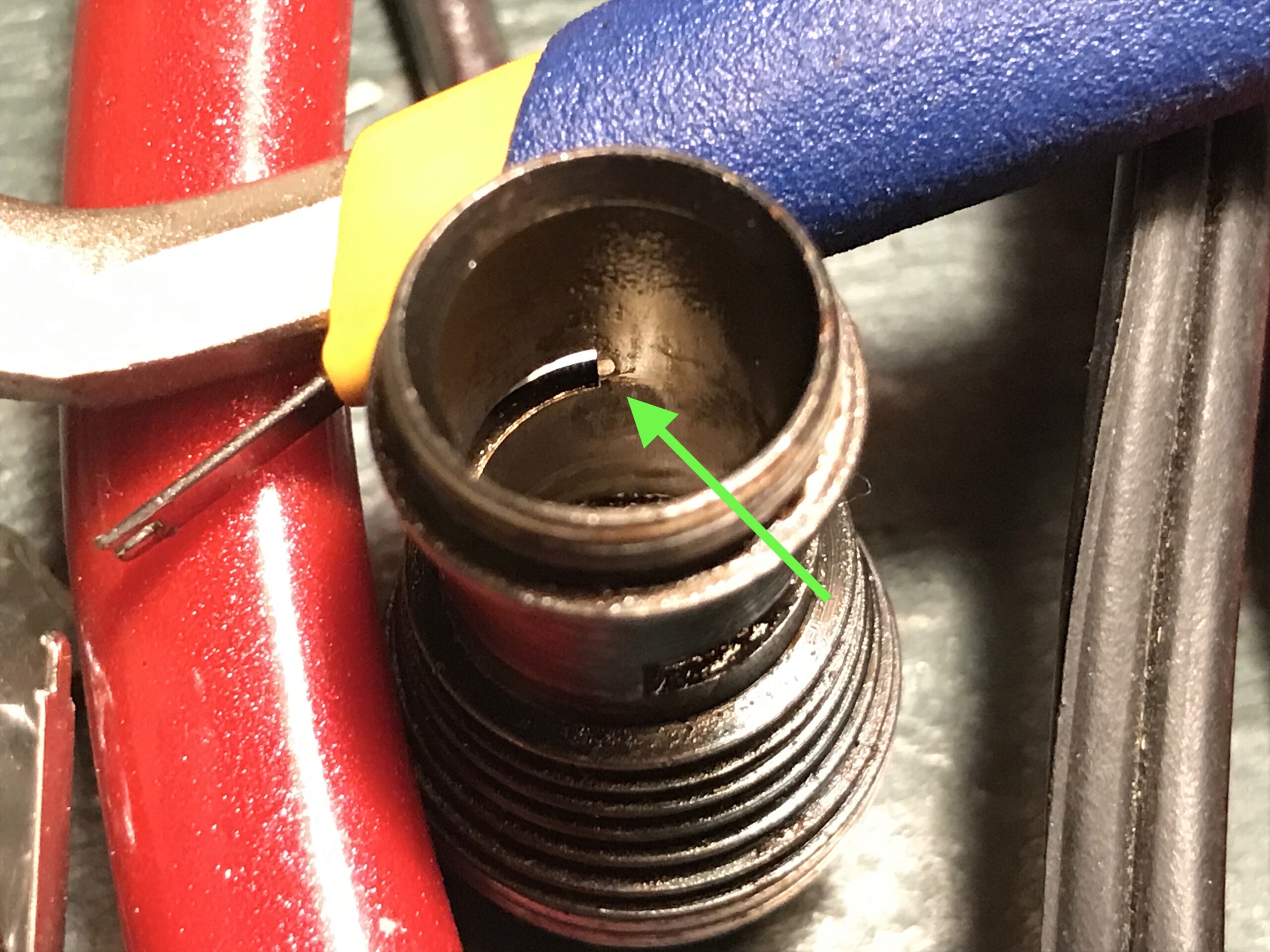

The engine is indeed stiff, tightens up right at the exhaust ports. Typical for a burr or minor dent in the exhaust port opening. Very easy damage to make with these early thin wall cylinder engines.

Worth a restoration definitely. I have fixed worse driveplates with drill and sandpaper (poor boy’s lathe). The marks on the cylinder don’t look too bad, and the snag around the exh ports can probably be honed with an old piston and some polishing compound as you know. That is, of course if you want to conserve the original parts Smile

The taper bore cylinder - all thin wall cylinders I have are taper bore, so yours maybe too- may make it difficult to remove the burr at the exhaust port by shoving an old piston down through the cylinder top.

balogh wrote:The taper bore cylinder - all thin wall cylinders I have are taper bore, so yours maybe too- may make it difficult to remove the burr at the exhaust port by shoving an old piston down through the cylinder top.
I consider possibly, András, that Kari was referring to complete cylinder removal, and honing with a piston from the underside, no? Smile
I have carefully removed such burring inside the cylinder from my wrenching through the exhaust port by carefully removing such burr with a fine round file and carefully stroking the area until sufficiently removed. Thus, have rescued such a cylinder by doing this. I have also ruined a cylinder by doing this. Doh! However, the equalizer was back then, cylinder-piston sets were inexpensive. Surprised
However, the beauty is cylinder-piston sets are still available from Cox International and Ex Model Engines. (When out of stock, a bit of patience and they are back in stock.) Smile (Of course, those living outside US and Canada are much more careful with their engines, because parts in their locale are harder to obtain. Sad
My solution if not restorable is to resort to one of my later engines with a good thin cylinder-piston, and replacing the donor engine with a new set.

You can have burrs which is from a chip of metal from the very edge of the exhaust port cut being scraped and bent into the cylinder, and then you can have dents where a bump is pushed in from the wall. Burrs can often be removed with an X-Acto knife or tiny file, then exercise with a junk piston for the final polishing if needed.
This one appears to have a dent right at the edge of the port. I've fixed that in the past with a little abrasive bit in a Dremel and making very careful short spot treatments until the piston has virtually no resistance at that point.
I don't want to go brute force by forcing a piston through it a bunch of times until it's smooth again, which could wear the opposite side of the cylinder that is also subject to friction due to the tight fit. I've done that in the past and it usually results in a usable engine, but with a cylinder and piston fit that is less than ideal.
1956 Babe Bee score Img_9715
You can see the raised portion of metal that has been polished like a mirror from the piston being forced to move past it.
1956 Babe Bee score Img_9714
If you look carefully, you can see where the edge of a wrench applied pressure on the wall of that exhaust opening cut, making a dent.

Yes, I meant the tip one of the resident engine gurus (I think Ken Cook) gave once, many years ago, when I had messed up a perfectly good Tee Dee cylinder.
In short, take a piece of suitable brass tube (3/8” ?), insert it into the underside of the piston, then use this combination by inserting it ”tube first” from the bottom side of the cylinder. The piston is upside down in this situation Smile Now rotate and work the piston up and down with polishing compound. Periodically clean it and test with the piston so that you insert it dry, in a dry cylinder (the right way up this time), it should stop at the top position, and then fall down and out of the cylinder with a slight tap of the finger.
I have since modified this method by supergluing a piece of tube into a junk piston (rod slack beyond repair, but good compression), works well for the initial honing process.
It also feels like a good way to match cylinders and pistons that originally did not come as a pair.

If you ever turned over the latest production Sure Starts, you will notice a very scratchy feel to them. I utilize my de burring method of lapping the piston upside down on these new cylinders. I only do it at the bottom of the bore. A twirling up and down motion with fine chrome polish followed by a good hot water and soap cleaning. I have to say it works quite well and the engines no longer offer that rough feel. I know many don't care for the newer Estes engines but I have to say I've had some real good runners. I will say it can be hit or miss as some just don't offer the same performance but overall, they can do pretty well.
If one finds themselves in a position where the burr is binding the piston, this is a great solution to a otherwise fishing weight. The cylinders are dead soft. The bigger problem is when the thin wall cylinder oblongs and goes out of round due to twisting. I don't have a solution for that as it's pretty much now a relic of the past.
