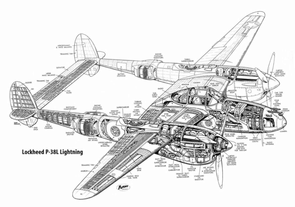

Not sustainable, limited interest so I got out my pinnable suspended ceiling build-board and laid out a second P-38 that I have been thinking about building for years.  Duane's Innovative Profile P-51 got me thinking.  Profile booms using his engine mounting design with a profile pilots pod.  But I may do a scale pod as I like canopies.
Guides and inspirations.

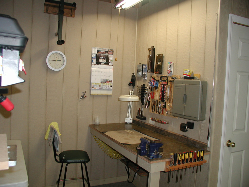

My "Clean and organized"
Mid-September, cold and rainy and a young mans thoughts turn to model trains and P-38's P1016223
Mid-September, cold and rainy and a young mans thoughts turn to model trains and P-38's P1016225
More like "normal."

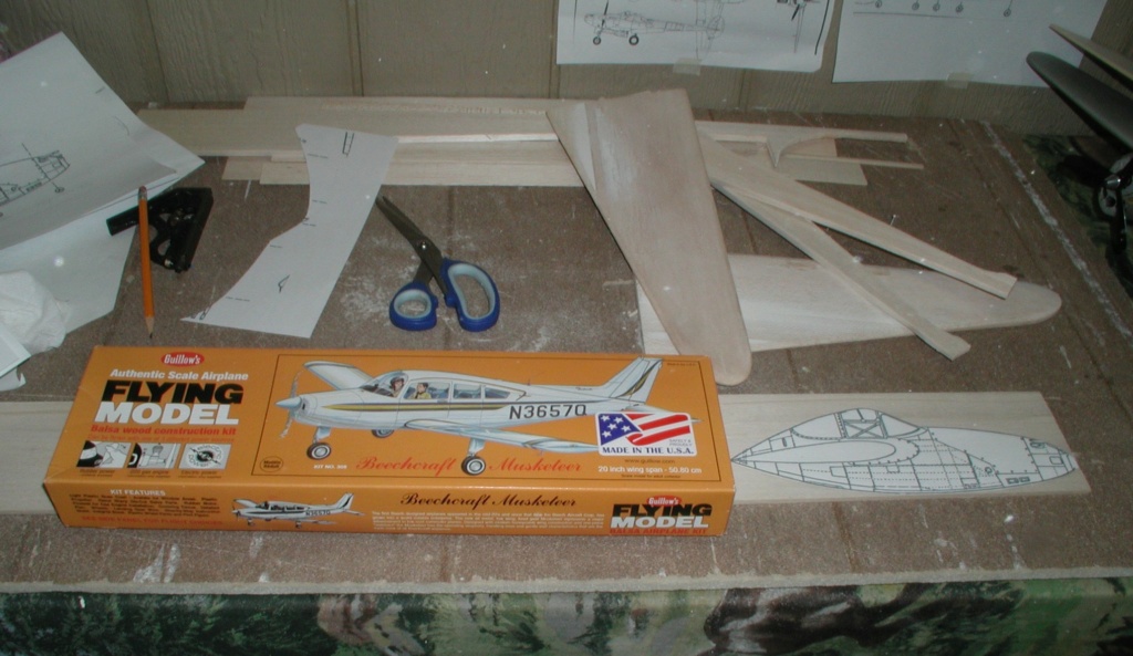

Cut out the second "boom" for the P-38 and finally scaled the cockpit pod to the wing.  Keeping it simple........profile. My pictured P-38 was of monocouge construction, hollow wing, boom's, and pod.

That is a very nice work space Bob, We are fortunate to have those when weather is not so nice outside…. I admire the organization!….. I stayed in mine a lot this summer when it was extremely hot….I have three of those yellow parts bins/drawers from HF like sitting on your white table…. One for .049’s and parts, One for .020’s, and one for rc electronics….Also have one like the blue one on the wall that’s probably forty years old, I think was from Sears (?) for small tools, Dremel tools and etc….
You are making your P-38 from three view drawings?…. Maybe also some reference to your old ‘38?….Your old P-38 is a very nicely built and detailed model, Something to be proud of Thumbs Up

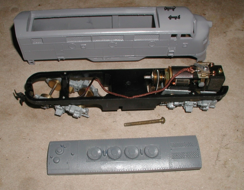

Thanks Robert - I love these old Varney F-3 coil spring drive locomotives, bought every one I could get my hands on, most very cheap and inoperatrive.  Coil spring belt drive with three tiered pulleys giving you a choice of three speeds.  Rebuilt most of them added new horns sandblasted and painted.
These pre-date the earliest Cox product by a couple of decades.  Gordon Varney pioneered model trains.

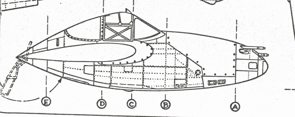

Yes, I saved all my drawings from my first P-38 build and added a couple.

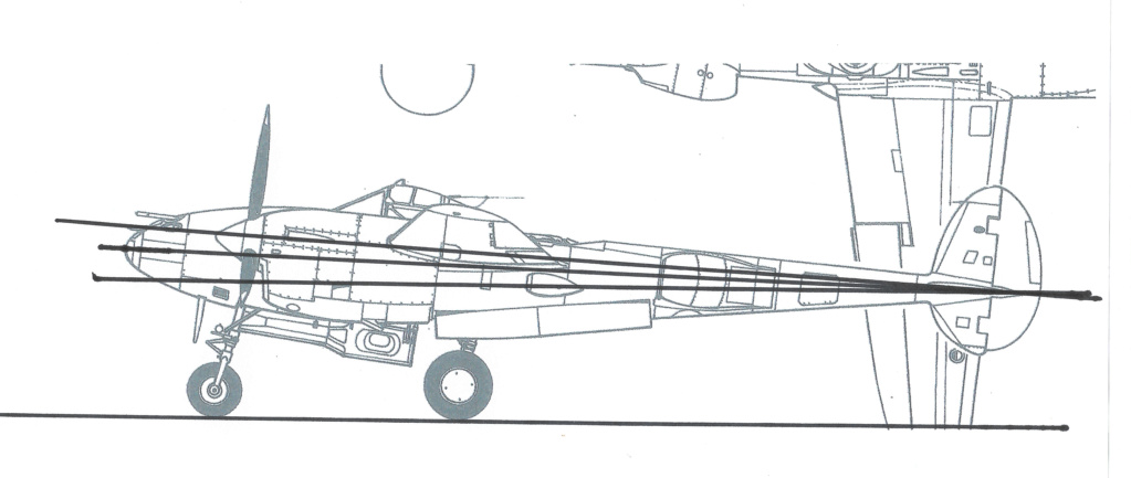

I had trouble figuring the thrust angles (angle of incidence) relationship with the wings chord and the horizontal stab on the original so I just selected neutral.  But I never did get it right as the plane seemed uncomfortable in flight always wanting to fly nose high.  Would like to do better on this one.

I had Mark scale the pilots pod to the rest of the aircraft coming out at 10 inches.  Profile, I'm just going to cut it out on quarter inch balsa and be done with it.  No canopy to deal with.  Soften the edges with sanding.  Will need a lot of detail add ons, air intakes, superchargers, etc etc
