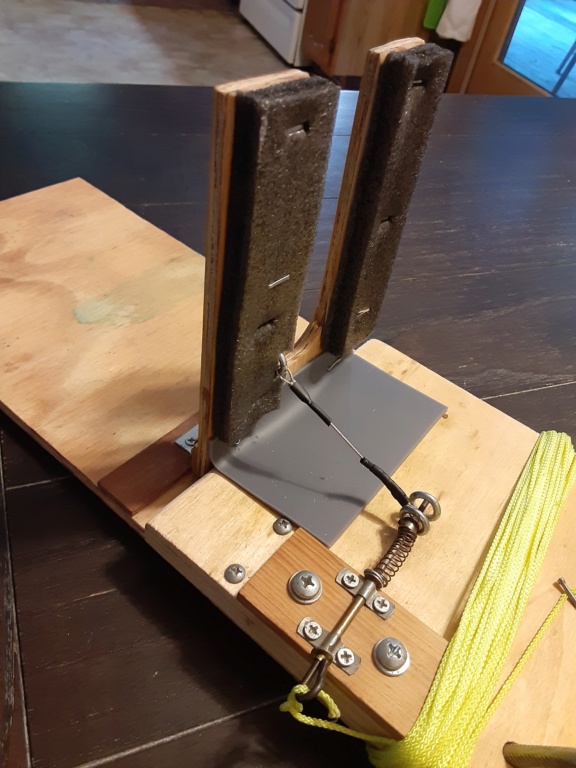

The design needed some fortification (and still needs a tweak or two..) but I'm happy with what I have so far. The release-pin "cable" that's captive to the fork was attached to a small screw-eye. I replaced it with a larger one, put some heat-shrink tube over the cable terminations and padded the backside of the fork.. which contacts the front surfaces of the airplane's stabilizer/stabilator.
My "fork" stooge for tricycle-geared 1/2A R.O.G. launching Goalpo14
My "fork" stooge for tricycle-geared 1/2A R.O.G. launching Goalpo15

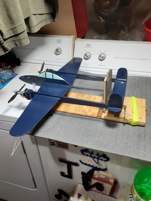

Here are the two subject models for which this stooge was purpose-built-
My "fork" stooge for tricycle-geared 1/2A R.O.G. launching 20230921
My "fork" stooge for tricycle-geared 1/2A R.O.G. launching 20230922

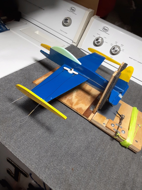

What's really nice is; my smallest airplane.. the "Flying Blind" should be able to be launched from this stooge.
My "fork" stooge for tricycle-geared 1/2A R.O.G. launching 20230923
Here are two examples of my "full-fuse" models that I wanted to work with this stooge. I don't see a problem.
My "fork" stooge for tricycle-geared 1/2A R.O.G. launching 20230924
My "fork" stooge for tricycle-geared 1/2A R.O.G. launching 20230925
What's left to do? I want to upgrade the fork release-cable to use large-size line-connectors on both ends.. especially where the pin rides in/out. The cable will wear and fray over time.

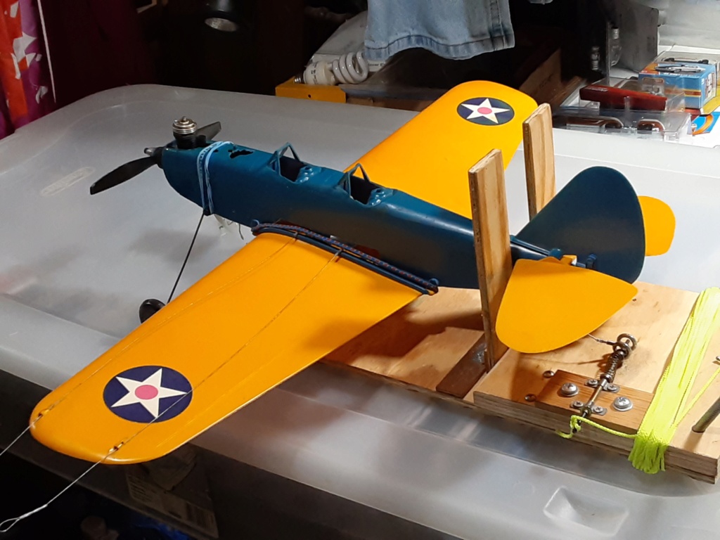

Some other photos of some of my airplanes staged in the stooge, taken before the mods were made..
My "fork" stooge for tricycle-geared 1/2A R.O.G. launching 20230926
My "fork" stooge for tricycle-geared 1/2A R.O.G. launching 20230928
My "fork" stooge for tricycle-geared 1/2A R.O.G. launching 20230927
My "fork" stooge for tricycle-geared 1/2A R.O.G. launching 20230931
My "fork" stooge for tricycle-geared 1/2A R.O.G. launching 20230930
My "fork" stooge for tricycle-geared 1/2A R.O.G. launching 20230929

Interesting airplanes roddie. Love the ganged flaps models. Rare Bear still a favorite.
Will the airplanes all escape the stooge before the flap folds?
Posts : 9963
My "fork" stooge for tricycle-geared 1/2A R.O.G. launching Empty Re: My "fork" stooge for tricycle-geared 1/2A R.O.G. launching
Post  roddie Fri Sep 22, 2023 2:57 pm
As soon as the flap/fork starts to fold/drop.. the model moves forward.. and thus the clearance between the "top of the fork".. and the wings' "trailing edge" increases.
