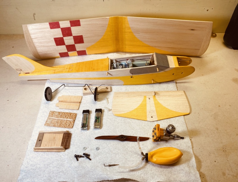

Andras, or anyone, What do you flush your balloon tanks with after an outing?…. The balloon lasts pretty good if used every once in a while but maybe a flush after use?…Easy enough just to replace the balloon if that’s best… I’m liking how these work
Apart for cleaning/maintenance after an outing…. Still in one piece!

Robert, I do not flush it, but after the last flight of the day, attach a syringe and pull it to full vacuum so that the last drop of fuel is emptied. Then I let it inhale/suck in some air just to make sure the castor on the tank internal wall does not stick it into a flat clump...the rubber withstands glow fuel ingredients for pretty long, several seasons..the minimal amount of castor leftower flushes off next time you fill her up..

Thanks Andras, Will do on evacuating the tank…. That’s easier than flushing anyway!….I also use vacuum as sort of a reverse leak check… Pull it down hard and see if will hold without trying to inhale…..
