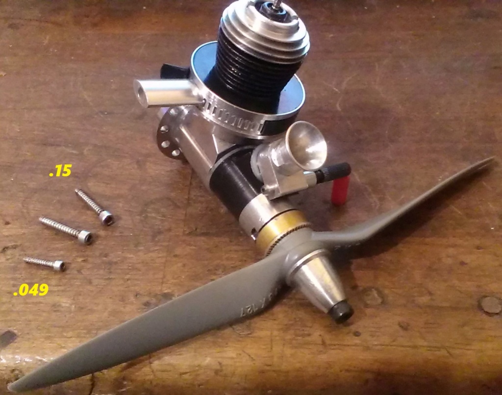

Post  1/2A Nut Mon Jun 24, 2019 10:40 am
No not yet,
I would like to use a good sealing / breathing header manifold on one.
If that happens I will put a timing wheel on expect 140- 145 exhaust timing.
Thus far ran 3 out of the 5 thus far they are beasts compared to the .09's
If you wish you can compare yours with a APC 7x5 to the following results. Ran as shown.
APC 7x5 /18,330 rpm / 37oz - 2.33 lbs thrust / .532 hp - 397w  / 87mph prop pitch speed.
