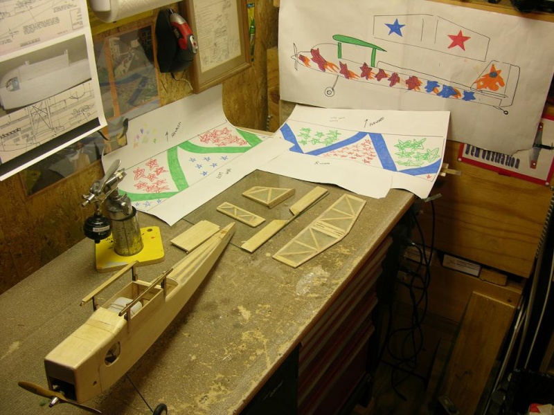

After the success of the first Little Traveler, with it's 15 mile non-stop cross country flight, I decided to try again with a new model airplane and double the distance to 30 miles non-stop. Once again, we hoped to gather donations to benefit St. Judes Children's Research Hospital in Memphis, Tennessee.
Paul Salmon, a local helicopter instructor and all-around great guy, volunteered his Robinson R-22 as a chase vehicle. I'd guide Little Traveler II from the left seat of the Robinson for the hour-long flight. We chose the airport at Cairo, Illinois as our launch site, with our goal being the private airstrip at Painton, Missouri...handily, almost exactly 30 miles away.
Little Traveler II .....May 19th, 2010 Little12
The first Little Traveler was a modified Sterling "Minnie Mambo", and for this project, I chose another high-wing 1/2A trainer; a Cox/Sanwa "Q-Tee". I widened the body and stretched the cabane struts to make room an 8 ounce Sullivan fuel tank in the little plane. Like before, I used two of Bernie's Cox micro servos, one of his .049 engines...a "Black Scorpion".
Little Traveler II .....May 19th, 2010 Little11
Little Traveler II .....May 19th, 2010 30_11
After expending a lot of effort shaping the nose block, I decided that I wanted the tank further up front to help keep the CG acceptable as the fuel was used up. I blocked it out with scrap balsa and hollowed it from the inside to make space to move the tank forward.
Little Traveler II .....May 19th, 2010 31_10
Little Traveler II .....May 19th, 2010 32_10
It's color scheme was designed by Leroy and Destiny Atkins, the son and daughter of Cape Girardeau's Assistant Airport Manager, Katrina Atkins.
