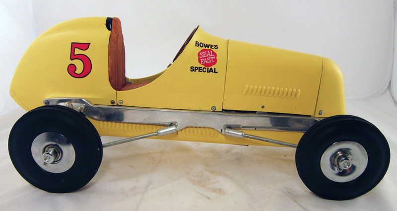

The similarities between my model and this one on eBay are striking and to numerous to be a coincidence. The louvres in the engine cowl and bottom pan are identical and unusual.
The cockpit dash, gauges and stering wheel are identical as are the fuel pump and hand brake. These and other features show they were build by the same person.
I,m going to send a note to the seller for any info.
  As for price the yellow Mercury has been for sale for at least 5 years, it will never sell for that. The Dooling models simply don't go that high. What is his motivation for running this and other listings over and over for years? I don't know.
http://www.ebay.com/itm/TETHER-CAR-ORIGINAL-DOOLING-Yellow-5-Mercury-/371247334155?hash=item567010c30b:g:KsIAAMXQVs1Rm95B

Thimble Drome Champion - Page 8 Doolin12
I could go crazy over these, the pictures above are extraordinary.
The one for sale, at that price would buy all my Enya and other engines, my model cars and airplanes, and I would probably throw in my full scale 2003 MX-5 Miata.
