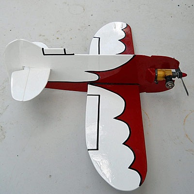

I used pin hinges in my foam core wing.
Another way to use Monokote as a hinge is to use it like you would use a tape hinge on a foamy. It works great, strong and clean. I've used Monokote hinges on planes as big as a .35 size c/l stunter with no problems.RknRusty wrote:As for Monokote hinges, once I tried ironing two strips together with the adhesive on opposite sides, planning to then iron them on in over/under fashion, but I could pull them apart, so I ditched that plan. Maybe I didn't do it right. But it sounds too lightweight for .35 stunter flaps. I could be wrong.
Here is a pic of my Gee Bee with a Monokote hinged elevator. I used one piece of covering for the top and one piece for the bottom on both the stab and elevator.
Shawn

Re: Back to the Yak - Yak-9 Build, Part II
Thanks, Shawn.
