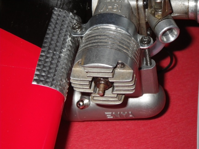

Here's the repaired and modified JR Satan:
I made a new skid out of music wire. I added the muffler with the cut off stinger. The strap-on bracket needed reshaping due to the narrow space between the cylinder and the leading edge. A 8x4 prop was fixed. The CG is now approx 3/8" more forward. Hope this helps.

Lieven, the Enya .19 is 2 1/4 oz's heavier than a Cox Medallion .15 and this is with no muffler. I've seen the cylinder snap right off more than once when used on combat wings when they strike the ground. The wire will not support the weight and the muffler will inevitably strike the ground and the Enya strap is tough stuff. I would seriously consider losing the muffler. You need horsepower and the muffler isn't going to allow the engine to make full power. Enya's really don't like being muffled when used in control line like I mentioned. Just something to consider. Ken

I've thought about what you wrote in your post, Ken. We discussed this muffler stuff before. I cut of the stinger as you said; the opening was a lot bigger than original. The wire skid would not resist a shock but it will at least kill it before it bends instead of breaking. So today I gave it another trie. I reduced the line distance on the handle. Adapting the launching technique as explained before, the plane climbed again, did a loop and hit the ground. The prop broke, so immediately, I fitted a new one.

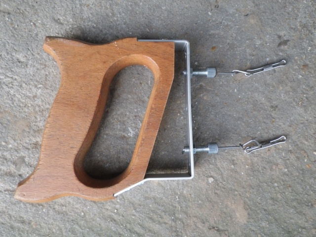

I use a self manufactured biased hard point handle.
In order to limit the up movement when launching, I attached my handle upside down to the wires forcing my wrist in an upward position. Amazingly, it worked. I got the plane flying. As it got up to speed, it was very fast and unstable. It was continuously flying like a roller coaster. I got very dizzy and wandered off my point. It wasn't fun at all. Until the plane hit a branch of a tree and went straight down. Once on the ground, I did one step and suffered the same fate.

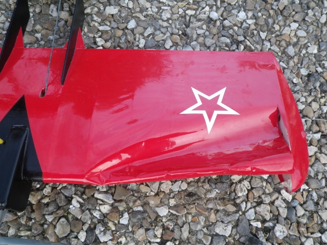

Damages (to the plane):
A bent wire skid
The inboard leading edge broke together with some ribs
The 4 screws of the engine's nose piece came undone.
The muffler rattled loose.

I almost wonder if it isn't the handle giving you issues, being an angled saw handle. A natural wrist would be perpendicular to your forearm.... just thinking outside the box.
What do I know... I don't fly CL
