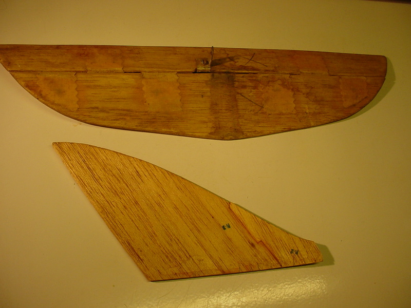

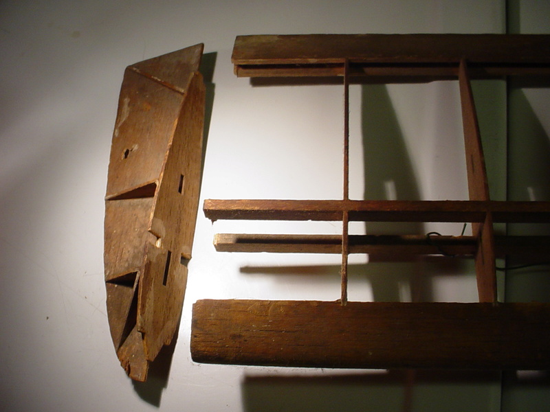

Check out this OLD Jr. Flite Streak wing! Built sometime in the late 60's/early 70's.. probably with Ambroid. I was holding the tip and looking at it's brace layout while it was hanging from the ceiling. To my horror..
the tip came "right-off" in my hand. There is no wood damage whatsoever..
That tip weighs 1.25oz. w/those 4 steel washers.. This wing was given to me.. along with a built.. but as yet; uncovered Junior FS.
Think about that.. when your tempted to fly an old heirloom...

This is a known problem with celluloid based items. Celluloid can go bad and "rot", sometimes in a contagious manner. The best answer is to paint the joints with fresh dope. This will soften and hopefully rejuvenate the old celluloid, and add a fresh layer of, well, glue.
If you have unusual suspect rusting going on you have the bad, potentially contagious, type of rot going on.
The straight razor section on Badger and Blade is where I heard about this first. I have also bought some bad blades that were subject to this funny rusting exactly inside the scales.

That's not unusual as Phil mentioned. It doesn't condemn the model to a life of languish though.
Just go through it, scrape away the old glue where possible. Re-glue it with ambroid or Sigment and Bob's your Uncle.
My Ringmaster is older and was in worse shape than the Streak in your rafters. I have enjoyed it immensely after repairs.

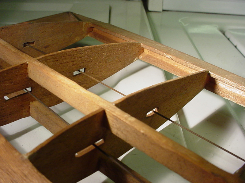

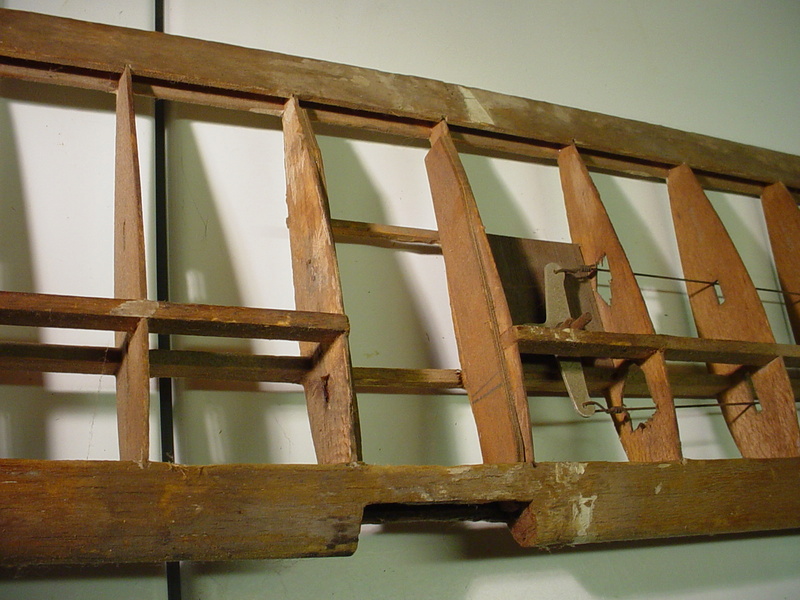

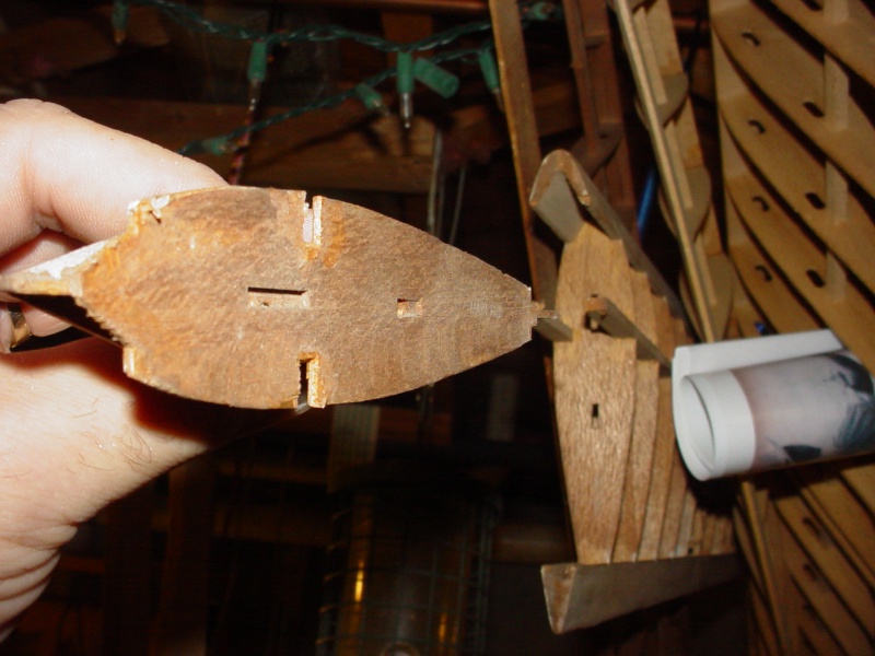

When I started this thread, I showed how a wingtip had separated from a Jr. Flite-Streak wing that my Uncle had given me.
Guessing it was built in the late 60's early 70's.. but he made some mods to the wing-root.. (check out the lead-out clearance-holes in the rib just inboard of the bellcrank..)
He was into "Combat".. around that time.. and I think he told me that he was trying to make a "flying-wing" out of it.. but he "did" hinge a JFS stab./elev. which I "do have".. as well as the rudder/fin..
Whatever.. blah blah.. These things should probably be thrown away.. as "Ken" mentioned recently.. when he "cleaned-house" of all the models that he knew he'd never repair/rebuild. He's a stronger man than I.

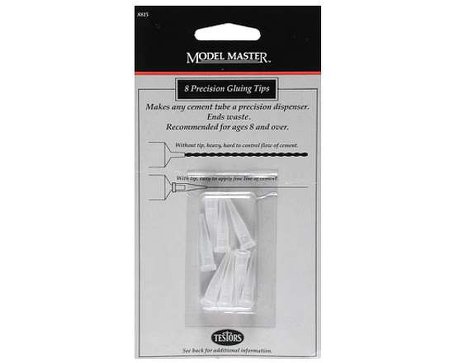

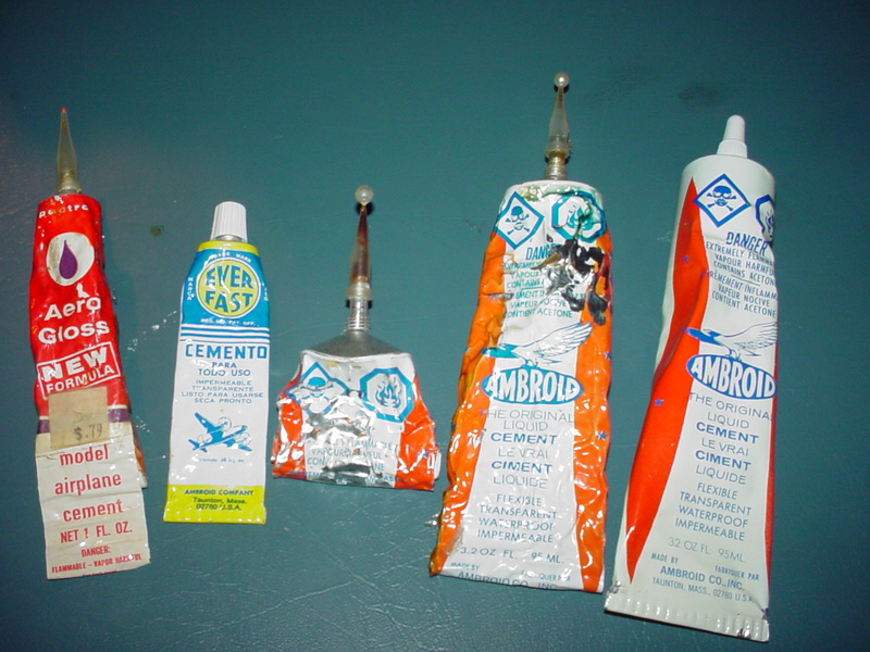

Back on topic (I digress).. When it comes to "re-gluing" old glue-joints.. If you can find these "Testors" gluing-tips..
They fit nicely on the nozzle of the Ambroid tubes that I have... and others too..
The extra "inch" of length on the end of a glue-tube really makes it easier to get into tight areas.. and the smaller hole in the tip, provides for a nice "thin-line" and easy to control application. My experience is mostly with "Ambroid". It flows effortlessly through the tip.. and doesn't "string" when pulling away. It's truly like having neat "needle-point" application.. which is really all you should need, to rejuvenate old spar/rib glue-joints in an old "Ambroid-glued" wing.. without adding unnecessary weight. Probably less than an hours-worth of work.. once the covering is removed.
I have several old C/L models that meet this criteria.. and most of them haven't been covered.. but have bellcranks installed with "solid" lead-outs.. old-school style.. except my S1 Ringmaster.. which has it's wing mainly built, but no bellcrank installed yet.
My wife gets BAD migraine headaches that are triggered by solvent-based chemicals.. which is partially why it's hard for me to move ahead with building and finishing. A ventilation system is something I've needed to install in my basement-shop.. but the only semi-accessible outlet, is one std. 15" x 30" window above the fuel oil-tank.. with one of the two panels occupied by the clothes-dryer vent. Maybe I could design a rack for small models.. that fits in the clothes dryer!

I use carpenters wood glue for probably 80% of my builds. No smell, easy clean up. Ambroid is gone and is a thing of the past. It worked well due to it's sandability. It was more important to me due to it's flexibility. It worked great for freeflight models in the wing area. CA glues wick into the wood, they don't flex and they CAUSE the wood to break just outside of the glue joint due to a stress created by it hardening the wood. Certain epoxy glues have a very bad smell and I've found a few with little to no smell. I personally hate CA. I use it when only necessary and it too has fumes which burn your eyes and or skin if you come in contact with it.

Yes.. it's most definitely an early Top-Flite "Jr. Flite-Streak" wing.

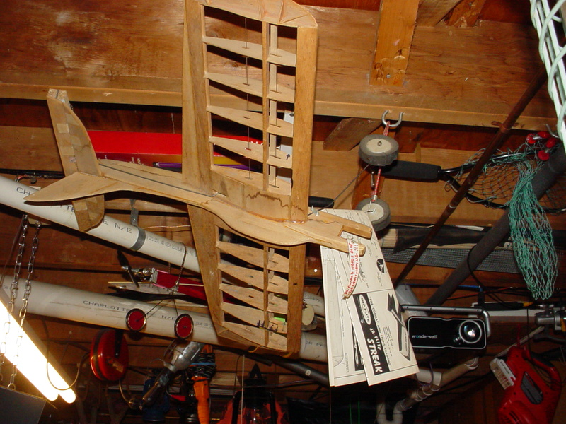

I have another JFS-same vintage, built but never covered.. which needs re-gluing of all its' joints.. The wing-construction is identical. One of the plywood nose-doublers; I noticed is delaminating at the front/beam. I'm almost sure it was built using Ambroid cement.

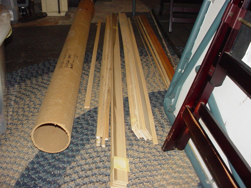

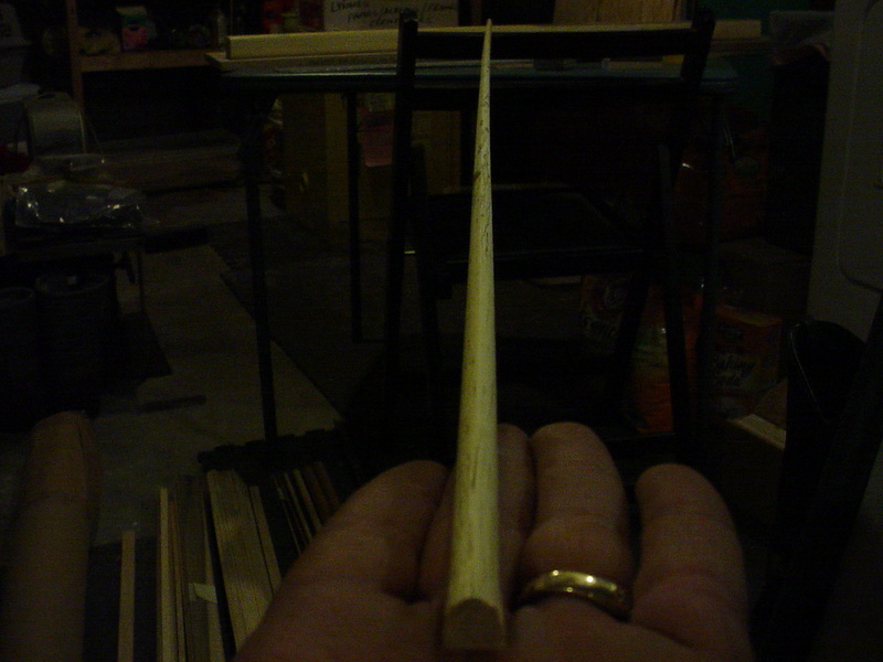

When I had access to a CNC router.. I used a small quarter-round bit to make some balsa L/E stock for small wings. The company made some signs from laminated-balsa "planks" that were 1.75" thick x 24" wide x 96" long. The scrap that was thrown out would make you cry.
Here's one of several pieces of L/E stock that I routed. They're 60" long.
I keep them in a cardboard-tube, along with some other pieces of 4'+ stock.
Replicating "Top-Flite's" Sureform leading-edge.. would take some fancy tooling/jigging!

Roddie, seeing you have that Flite Streak you should pursue the avenue of at least finishing it. Plywood and Ambroid never really worked well. I bet at this stage using a spatula you could peel them right off. If that's the case, sand the fuse cut new doublers and glue the new ones on. Heck, you could even use that Stallion on there if desired. A bit heavy, but the Streak is a flighty plane and for those not used to it, it can quickly be put into the ground. Re do the bellcrank platform and reglue all the joints. They're terrific planes and built exceptionally well which takes a good bit of abuse. I no longer have my FRIGHT STREAK which was a Flite Streak with a Fox Combat Special on it. It would fly at about 110 all day long on 10% nitro. We kept putting higher and higher nitro in it and every outing usually resulted in the plane or engine breaking. One afternoon the entire bellcrank platform broke loose, another time the wings folded, and yet another time the tail snapped off due to hard maneuvering. The Streak though can be loads of fun with just a Fox .35 stunt. I even have my first one here with a OS FP .20 on it. It weighs a ton but it still flies well for a sport job.

Yea.. it's "been" on my modeling to-do list. Rusty's got the K & B engines. I was just asking him if the .35 was a Stallion like the one in the pic. My Flite-Streak is the smaller 31" span/230 sq. in. "Jr.".. for .15 to .25 engines.

Rusty, the construction is identical to the wing that Roddie depicts from the rafters and his close ups. Over and under spar (Typical) and solid leading edges and trailing edges. Single platform bellcrank which is very poor for this model it was just true to design of the times. Anyone considering running hotter mills beefed up the controls anyhow. I also substitute the balsa spars for spruce.
