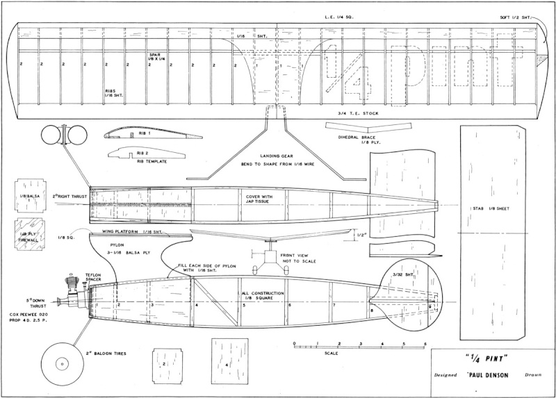

There´s other version small, called Quarter pint  Small Cox Logo  Babe Bee .049 powered
Half Pint (Louis Garami) 1940 Quarte10
Here the plan by Paul Denson 1972
Half Pint (Louis Garami) 1940 Quarte12
Here Steve model builder
Half Pint (Louis Garami) 1940 Quarte13
http://www.airplanesandrockets.com/airplanes/quarter-pint-apr-1972-aam.htm
I nix both planes to build me version.  Spain

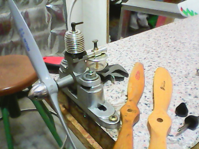

I choose for the first flights indian replica diesel engine of english Mills 1.3
Half Pint (Louis Garami) 1940 Mills110
I test some props
Half Pint (Louis Garami) 1940 Img-2010
And I´ve good resutls with flex plastic white Thimble drome 9x4" used by Tee dee .15
Half Pint (Louis Garami) 1940 P1010512

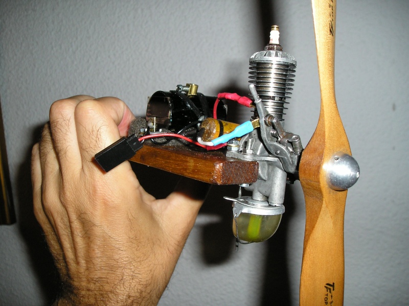

Half Pint (Louis Garami) 1940 Empty Direction control system
Post  jmcalata Mon Sep 14, 2015 3:01 pm
Keep on
I try to explain ... now ... how ... I thought at first turn my airplane.  Huh...
I don´t want to made ailerons in the wing and also I don´t make complex sistem to operate rudders.
Half Pint (Louis Garami) 1940 Images11
Then, I made two elevator and make a mix in the radio to up and down both as elevaitor and turn alternate as taileron.
Half Pint (Louis Garami) 1940 Images10
But I test in the first flights that tailerons don´t work as I hope. Sad
Half Pint (Louis Garami) 1940 Elevon10
