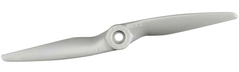

Thanks for the tip, Kris. Unfortunately the Graupner props for engines are hard to obtain here in US. Tower Hobbies no longer carries them. APC does make a sport prop in 6x3, which may be a good alternative for me.
Thanks for the numbers, Kris, they illustrate that the power of the .074 is similar to the Cox .049 / .051 Tee Dee's, as the writers (articles available in Sceptreflight) did indicate with the 6x3, it throttled nicely. I just found it odd that the prop hub was designed for larger props but engine was suited for half-A ones with overall smaller hubs.Here are some numbers for the Queen Bee on 10% nitro and 20% all castor;
