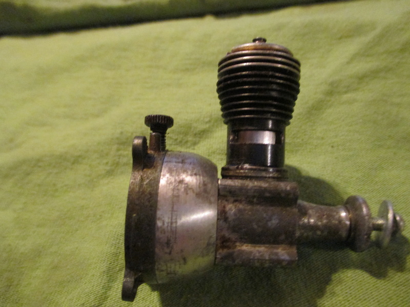

I have read not to clean engines with WD40 after running. Can someone tell why and what to use?
