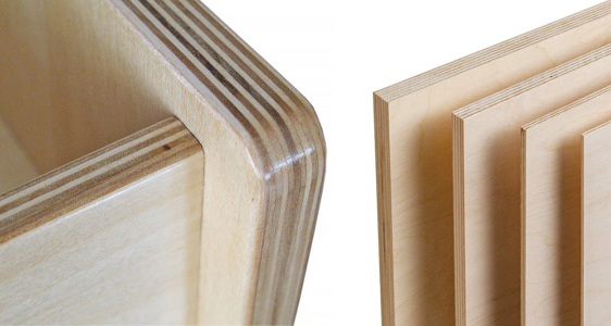

Post  roddie Tue Feb 21, 2017 8:04 pm
getback wrote:New the handles look pretty good man i have tried to make some before and my scroll saw want cut that thickness of wood , i may can jig saw them Shocked wow gave me an idea . Mark i like the mod. on the  Goldberg handle , how did you get those rings in there? i like the feel of that handle. Small Cox Logo
I'm curious too Eric. I have one of those Goldberg 1/2A handles new in the package. Maybe Mark used a small pair of "split-rings" to connect his line-connectors? You can find those in the "craft-jewelry" department at your local Walmart.
Keep an eye-out for "Baltic-Birch" plywood for the hand-grip portion of a wooden handle. Baltic-Birch plywood has twice the ply's/thickness as conventional plywood.. and is SUPER strong. Use your jig-saw to rough-out the grip.
Homemade Control Line Handles Baltic10
When you contour-sand the grip to comfortably fit your hand... the multiple-ply's produce a nice custom appearance.
Homemade Control Line Handles Baltic11
You can then "slot" the handle to insert an aluminum plate to your liking. That's the challenging part.. but it can be done with a hack-saw and jig to get it on-center.
