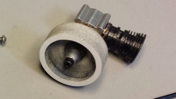

roddie wrote:It's been over a year.. but today I decided to give those consigned Cox engines that I scored, some attention. None of them would turn-over.. but I was hoping that they were merely just castor-locked from not being treated to a little after-run oil before being put away.. which is sOoOo often the case with "stuck-engines".
I prepared my work-space by getting out my heat-gun.. and securing a place to hang it nearby to my bench-vice; allowing it to cool-down between uses. I dug-up an old glove for handling a "heated/hot-engine" and also made a "wall" for behind my bench-vise.. to protect the area behind it from excess heat.
I needed a means to rotate the engines' crankshafts after applying the heat, to see if they'd loosened-up.. so I chose a PVC flywheel that I'd made. A propeller would work equally as well though.
One at a time; my engines were placed on my vises' anvil.. with their cylinders facing the heat. It only took half a minute on my heat guns' "LOW-SETTING".. to free-up all six engines. A few drops of light-oil "worked-in".. will keep them on "stand-by status".. until I'm ready to configure them for models!
Please explain this flywheel, I would like to make one for myself.

Re: Roddie scores some glow engines!
Geez..
The OD measures 1.375" diameter
The ID measures 1.125" diameter
The bore-depth is .400"
The center-hole is .125" diameter
It's important that the flywheel balances. Turning a flywheel on a "lathe" or CNC machine will ensure this. The .125" diameter center-hole is the correct size to accept the #5-40 machine-screw which fits the Cox .049/.051 engines' crankshaft.
roddie wrote:
Geez..I'm sorry Steve. I usually reply promptly to inquiries. The flywheel shown was made on a CNC router from 1/2" (.500") thickness PVC sheet commonly used in the sign-making industry.
