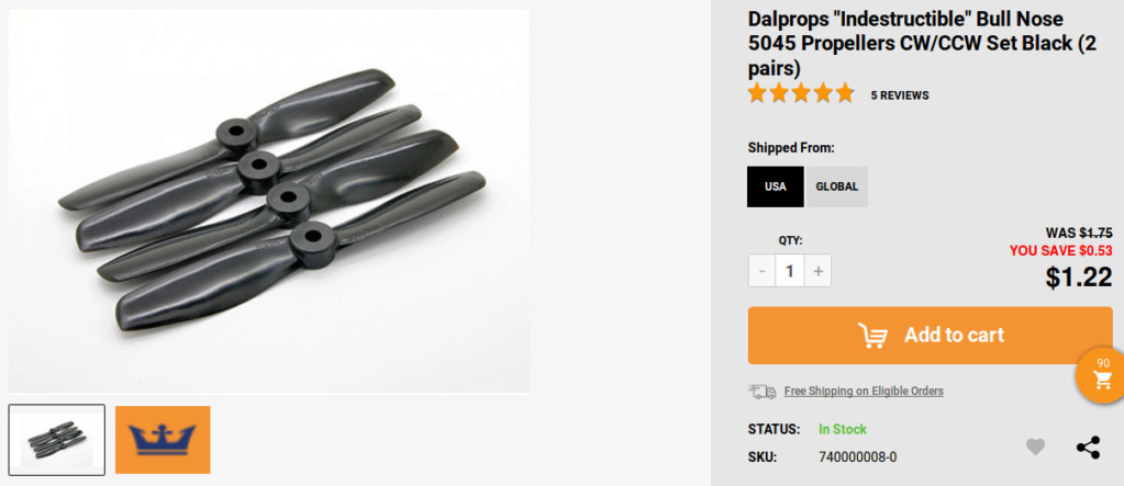

Don't know exactly where I read it, may even have been a posted by 1/2A Nut on either RC Groups or RC Universe. The post mentioned success using Bullnose props. The post mentioned that they were sturdy enough for 1/2A engine use. I don't know if they would be suitable for aggressive use like on a high nitro fueled .049+ Tee Dee, but am considering getting them for reed valve and possibly Medallion use.

Seeing these have a 4.5 pitch, I have always used 5x3 props on my cox .049 Reedies, and they perform well. Is the 4.5 pitch going to slow the rpms down and slow my 1/2A's down? Would the 4x4.5 prop be better?

I used the example so folks would know what a Bullnose prop looks like, but not as specifics for any particular engine. I can't speak whether suitable for the Killer Bee and ultra high performance reed valves because I don't have them.
I have found that for maximum performance on moderate nitro fuels (i.e., 15% up to 25%), I've had good luck with standard 6x3 props with Babe Bee, Golden Bee, Black Widow and R/C Bee (Sure Start piston cylinder set). At sea level some 30 years ago, I found little difference between a 5.25x4 and 6x3 Top Flite white nylon prop (the one with the red letters and stripes silk screening.) As such, I used them interchangeably.
I've used 5.25x4 props and yes they will work, but found that at elevation, they produce less thrust than a 6x3. Some years back when I was living in Gallup NM at 6,500 ft. elevation, the 5x4 props barely pulled my Q-Tee along, struggling for altitude. As soon as I propped engine with a 6x3, it flew with decent speed and had a decent climb. This mirrors Peter Chinn's observation that a 6x3 is an optimal prop to use, within peak horsepower band.
Of course, with higher nitro, high compression glow heads, the paradigm may shift to 5 inch props as being more advantageous. Those who are high performance speed fliers would know. I don't, because I've never gone there before.

That's all I needed to hear as I thought that 4.5 pitch is to much for my reed valve engines, it won't let them rev up. thanks.
