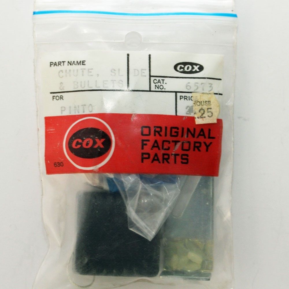

NEW222 wrote:Do you have a picture of the original? May be able to make a tin version if the shape and dimensions were known.
Wish I did have a picture of one outside the car.
Cox Pinto Funny Car - Almost to easy - Page 2 Pinto_13
This one?
Cox Pinto Funny Car - Almost to easy - Page 2 Cox-0411
There's also this:
Cox Pinto Funny Car - Almost to easy - Page 2 Cox-pi10
https://www.worthpoint.com/worthopedia/cox-pinto-funny-car-stinger-more-fuel-537078262

There may be a hint here..
Cox Pinto Funny Car - Almost to easy - Page 2 _5710
Cox Pinto Funny Car - Almost to easy - Page 2 _57-b10
The manual will tell you for sure.. but it looks to me as though the parts called "bullets" are what close the throttle and deploy the drag-chute. I would guess that a single bullet is threaded-onto the guide-line (and maybe secured by a knot?)somewhere around 3/4 of the way down the track.  Huh...  Huh... ???
You may have also seen the below photos.. but I'll post em' because of their relevance..
Cox Pinto Funny Car - Almost to easy - Page 2 D5_sch10
Cox Pinto Funny Car - Almost to easy - Page 2 De_09610

Post  rsv1cox Wed Jan 30, 2019 6:12 am
roddie wrote:There may be a hint here..
Thanks for those pictures roddie, helps a lot. I have never seen what those little "bullets" look like.
I did receive that manual bought on ebay for $13. + and near worthless. A reprint so light it's barely readable, cut at an angle and stapled together randomly. Gotta leave one of my very rare negative feedbacks.
And Jason. They look great. PM sent.
